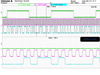

The sampling rate of our application is 44.1kHz.
When FS MODE is set to 44.1kHz, Clock error occurs (Flag:CLK_FAULT_I).
And we confirmed register CLKDET_STATUS Register (Offset = 39h), but no flag is set.
When FS MODE is set to auto detection, no error occurs.
What could be the cause of these error?
