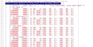

    Also add more log in the aic32x4_setup_clocks to check why it cause issue. It seem that platform can't support the clk to be set.
    It seems that the cause of the failure is that the following code does not pass.
      if (clk_round_rate (clocks [0] .clk, dac_clock_rate) == 0) {
    Do you know an easy way to make sure this setting is normal?
      ret = devm_clk_bulk_get (component-> dev, ARRAY_SIZE (clocks), clocks);

    I checked the text.
    It seems that the cause is that the parent is not set to the "pll" that the TVL320AIC32x4 driver has internally.
    It seems that the best parent clock is selected, "pll" seems to be set only on the TLV320AIC32x4 probe.
    [ 7.918511] WVC:tlv320aic32x4; aic32x4_probe() start
    [ 7.923434] WVC:tlv320aic32x4; aic32x4_probe() np ---> aic32x4_parse_dt()
    [ 7.930337] WVC:tlv320aic32x4; aic32x4_parse_dt()
    [ 7.935142] WVC:tlv320aic32x4; aic32x4_parse_dt() ret=0
    [ 7.940443] WVC:tlv320aic32x4; aic32x4_parse_dt() aic32x4->rstn_gpio=-2, aic32x4_setup->gpio_func=0,0,0,0,0
    [ 7.950298] WVC:tlv320aic32x4; aic32x4_probe() aic32x4->mclk_name=audio-controller
    [ 7.957953] ASoC TLV320AIC32x4 clk : aic32x4_register_clocks() mclk_name=audio-controller
    [ 7.966229] ASoC TLV320AIC32x4 clk : aic32x4_register_clk() devname=0-0018, desc->name=pll
    [ 7.975009] ASoC TLV320AIC32x4 clk : clk_aic32x4_pll_get_parent() val=11, ret=0
    [ 7.982015] ASoC TLV320AIC32x4 clk : clk_aic32x4_pll_recalc_rate()
    [ 7.988289] ASoC TLV320AIC32x4 clk : clk_aic32x4_pll_get_muldiv()
    [ 7.995555] ASoC TLV320AIC32x4 clk : clk_aic32x4_pll_calc_rate()
    [ 8.000815] ASoC TLV320AIC32x4 clk : clk_aic32x4_pll_get_parent() val=11, ret=0
    However, at this stage, the best_parent_rate is not set, and I think that the parent clock cannot be found.
    The best_parent_rate is set when the aplay command is executed. The parent of "pll" remains empty.
    Is there a way to re set the parent clock for "pll"?

    Isn't the following set by the TVL320AIC32x4 driver?
    pll
    codec_clkin
    ndac
    mdac
    nadc
    madc
    bdiv
    I would like you to give me your advice
    I'm having trouble setting the parent clock for "pll".
    The TLV320AIC32x4 driver registers the following clocks in the probe request.
    "pll", "codec_clkin", "ndac", "mdac", "bdiv"
    It's in tlv320aic32x4-clk.c file(static struct aic32x4_clkdesc aic32x4_clkdesc_array[]).
    Operation steps for the TLV320AIC32x4 driver;
    1. Read the parent clock name from the device node. "aic32x4->mclk_name=audio-controller" is read out on my system.
      ret = of_property_match_string(np, "clock-names", "mclk");
      aic32x4->mclk_name = of_clk_get_parent_name(np, ret);
    2. Each clock is registered by the "aic32x4_register_clocks(dev, aic32x4->mclk_name)" function.
      aic32x4_clkdesc_array[0].parent_names = (const char* []) { mclk_name, "bclk", "gpio", "din" };
      aic32x4_clkdesc_array[1].parent_names = (const char *[]) { mclk_name, "bclk", "gpio", "pll" };
    Note:The parent_names of "aic32x4_clkdesc_array[]" will be registered after being updated by aic32x4->mclk_name.
    That is, it replaces the audio-controller.
    3. Registration is now complete.
    I checked the clock status with "cat /sys/kernel/debug/clk/clk_summary" command.
     pll                                  0        0        0           0          0     0  50000
        codec_clkin                       0        0        0           0          0     0  50000
           nadc                           0        0        0           0          0     0  50000
              madc                        0        0        0           0          0     0  50000
           ndac                           0        0        0           0          0     0  50000
              mdac                        0        0        0           0          0     0  50000
                 bdiv                     0        0        0           0          0     0  50000
    I tried changing the device tree in several ways but it didn't work.
    Is it a problem with the Simple-Card driver? Or is it possible to avoid it by modifying the TLV320AIC32x4 driver?
    Does the TLV320AIC32x4 driver expect an audio-controller for the "pll" parent clock?
    There is no "audio-controller" on my system.
    I suspect sai1a_mclk is an alternative, but I can't read it.

  • Since hard to set the clk setting on your platform.
    You can set a fixed mclk
    use following setting.
    static const struct aic32x4_rate_divs aic32x4_divs[] = {
    //mclk rate nadc madc aosr ndac mdac dosr
    {12288000, 48000, 1, 2, 128, 1, 2, 128},
    {12288000, 24000, 1, 4, 128, 1, 2, 256},
    {12288000, 12000, 1, 8, 128, 1, 2, 512},
    { 8192000, 32000, 1, 2, 128, 1, 2, 128},
    { 8192000, 16000, 1, 4, 128, 1, 2, 256},
    { 8192000, 8000, 1, 8, 128, 1, 2, 512},
    {11289600, 44100, 1, 2, 128, 1, 2, 128},
    {11289600, 22050, 1, 4, 128, 1, 2, 256},
    {11289600, 11025, 1, 8, 128, 1, 2, 512},
    //mclk rate 0x12 0x13 0x14 0x0b 0x0c 0x0 d-0x0e
    {15360000, 48000, 1, 2, 128, 1, 2, 128},
    {15360000, 24000, 1, 4, 128, 1, 2, 256 },
    {15360000, 12000, 1, 8, 128, 1, 2, 512 },
    {10240000, 32000, 1, 2, 128, 1, 2, 128},
    {10240000, 16000, 1, 4, 128, 1, 2, 256 },
    {10240000, 8000, 1, 8, 128, 1, 2, 512 },
    {14112000, 44100, 1, 2, 128, 1, 2, 128},
    {14112000, 22050, 1, 4, 128, 1, 2, 256 },
    {14112000, 11025, 1, 8, 128, 1, 2, 512 },
    Thank you for the advice.
    How do you use this table(aic32x4_rate_divs aic32x4_divs[])?
    Do you want to match the sample rate in the aic32x4_setup_clocks() function and set it with clk_set_rate()?
    Do you have sample source code?
