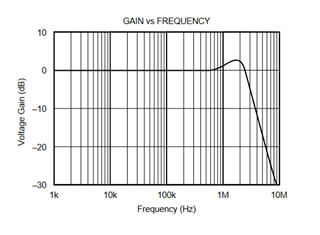

Looking at the INA134 datasheet it shows that the frequency response has a 2-3dB peak at 2MHz, which is also observable when measuring in real life.
What is the standard way of nulling this peak without compromising input CMRR?
I'm curious as to why this product is designed this way, I assume the reduced phase margin must be a design decision based on listening tests rather than measured performance?
Thanks for any insight..

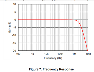

    I will take a look to see what data I can pull up on the INA134. This may be a challenge given the age of the device but I will see what I can dig up. In the mean time, have you considered the modern INA1650 or INA1651? It has significantly lower noise than the INA134. In addition the peak that exists in the INA134 doesn't exist in the INA1650. There is even an integrated buffered mid supply output which can be used to bias up the whole circuit to mid supply on a single supply setup. If this device is of interest I can also help you with it.

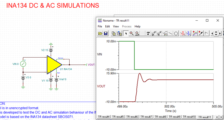

    To follow up on the INA134 phase margin, I have simulated the step response in order to approximate the phase margin.
    The percent overshoot is:
    P.O = (15.9mV-10mV)/20mV *100% = 29.5%

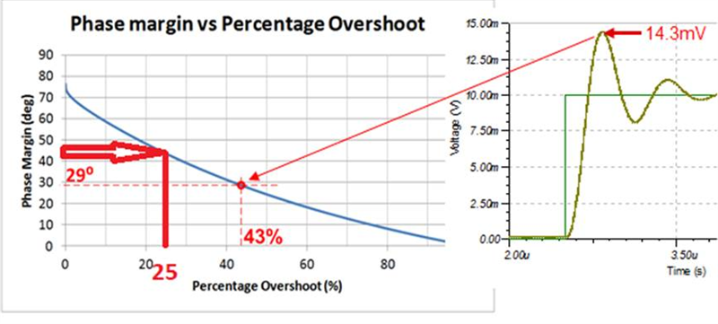

    A percent overshoot of 29.5% corresponds to a phase margin of approximately 40 degrees. Please ignore the step response in the slide below.

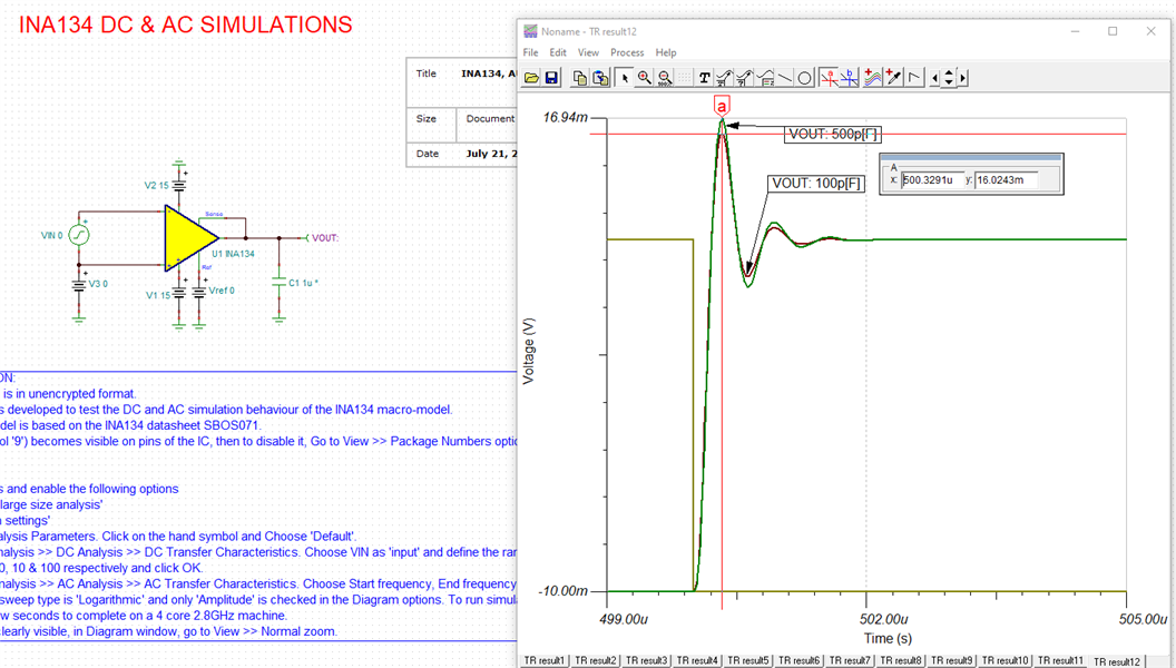

    With a capacitive load of 100pF I see around 30.1% of overshoot corresponding to around a little under 40 degrees of phase margin. This simulation closely matches the step response seen in the product datasheet.
