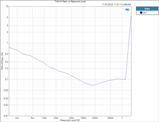

  • Actually, I measured THD+N under the following conditions, however the result was 0.25% in minimum. Could you point out what is wrong with my measurements?
    Measuring equipment : APx585 + AUX-0025
    Generator frequency : 1kHz
    Measurement object : TPA2016D2EVM
    Load (resister) impedance : 8ohm
    Power supply : 5VDC
    Fixed gain setting : 6dB
    Output power : 0.73W
    The datasheet says that I should get less than 0.1% under the above conditions.

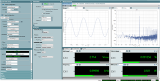

  • I apologize that my previous information was not enough and included wrong value.
    My PVDD level was 5VDC from stable DC power supply.
    The output power when I got 0.15% THD+N was NOT 0.23W BUT 0.92W (2.71Vrms on 8ohm resistor)
    At the time, input level was 1.36Vrms, therefore 6dB gain was as expected (20*log10(2.71/1.36)=5.99)
    Under the above condition, the datasheet suggests ~0.09% and my result (0.15%) is still larger.
  • Thanks for adding more details, I'll do the same test on my side, however I think the value you're measuring may be correct already as it's close to the plot.

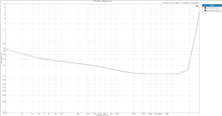

  • Attached is my test result:
    Register settings: c3 05 0b 00 06 ba c0
    -Ivan Salazar
    Applications Engineer

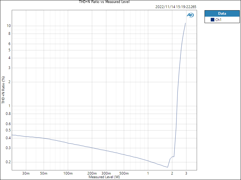

  • I'm sorry to visit here again.
    Could you measure THD+N under the following conditions and give me the result?
    Load (resister) impedance : 4ohm
    Power supply : 5VDC
    [I2C settings]
    Attack Time : 6.402 msec/6dB
    Release Time : 164.4 msec/6dB
    Hold Time : 0msec
    Compression Ratio : 1:1
    Noise Gate Threshold : 1mV
    Fixed Gain : +12dB
    Max Gain : 30dB
    Limiter : Disable
    And could you refer to the attachment (my result under the above conditions)?
  • I tested on my side for two different configurations:
    • Register settings: c3 05 0b 00 06 ba c0  (6dB fixed gain)
    • Register settings: c3 05 00 00 0c 9a c0  (12dB fixed gain)
    Unfortunately there is no clear comparison vs data sheet plot, as the only THD+NvsPout @ 4-Ohm is spec for "QFN only".
    You may double check the resistor you're using for measurement has proper current/power rating. You may also add an inductor in series to match the usual test load 4-Ohm + 33uH, if not using it already.
