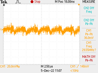

  • During playback or arecod, would you be so kind and capture the I2S clk waveform including WS clk and bit clk to me?
  • At the start of arecord. Blue BCLK and Yellow is WCLK.
  • The clks seems awful. What the sample rate do you want to record? The bitclk is 59.92Hz, wclk is 11.12Hz. None of two are the good clk freq.

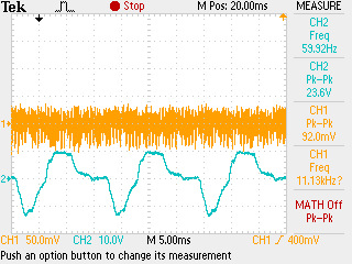

    One more thing, kindly get the sequence of i2s and i2c clk. In theory i2s clk should be earlier than i2c clk(codec power on command).
  • Yellow(CH.1) is I2S CLK same as BCLK. Blue(CH.2) is i2c CLk/ SCL
  • still abnormal. Can you share the DTS file? and tell me how you make these clk work.
