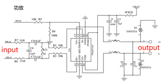

A, Application Description
Input: Class D output signal connected to Qualcomm QCC3040 Bluetooth chip
Output: bone conduction sound unit connected with 8 Ω impedance.
The corresponding PCB layout is as follows:

  • Hi Zero,
    I think this same application came up to the forum some time ago but discussion didn't continue.
    Can you try by adding a filter at the output, ie. populate L2, L3, C15 and C16?
    You must consider that TPA2011D1 is a Class-D amplifier, thus the output signal is a fast switching PWM, usually for normal speakers this kind of signal is not a problem, as the offset is cancelled due to BTL (differential) connection to the speaker. However if this specific actuator is more sensitive to these signals, then you may need to use the filter.
    -Ivan Salazar

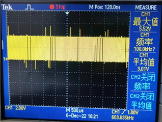

    In addition,

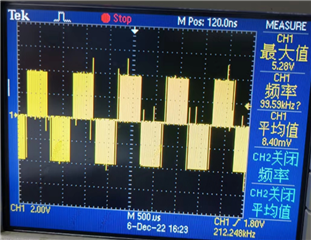

    After testing, we found that the DC voltage at TPA2011D1 output terminal was caused by a faulty square wave signal, and the waveform was all above the zero point, as shown in the figure below.
    In the normal prototype test, the waveform is distributed on both sides of point 0, as shown in the following figure.
    So I think it is not that there is no filter circuit that causes the sound unit to burn, but that there is something wrong with TPA2011D1, and I don't know what is wrong?

    I have a few questions on these scope captures:
    • The scope shows only CH1, does that mean a single output is producing both positive and negative? How are you measuring the output?

  • Hi Ivan,
    I test the signals at both ends of the load. Connect the probe of the oscilloscope to the S+ and S - test points in the figure below.
    Wherein, C15 C16 is NC, L2 L3 is 0R, and D2 D3 is ESD diode.
    When I play the sound signal, the waveform measured at the load end, because TPA2011D1 is a mono power amplifier, there is only one channel waveform CH1.

  • Hi Ivan,
    The above figure is the waveform of the output error, which is tested from the defective products.
    The defective products were fed back from the market consumers, and no such defective products were found at the production end of our factory.
    At present, the sales volume is about 20000 pcs, and the defective products fed back by consumers are about 30 pcs.
