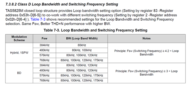

Regarding "PWM Switching Frequency" and "Class D Loop Bandwidth" in Advanced SRT in Simple Register Tuning, in actual use, should both be set to the maximum value?
Takeru
Hi Takeru
Seems the information is missed in this datasheet, below table from TAS5825, we could follow the same rules. Larger Bandwidth will help to the THD performance, but need to use the higher PWM at the same time, may get lower efficiency.
