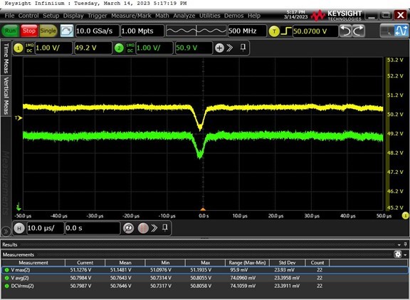

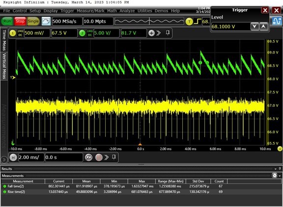

  • Hello again,
    I think that it doesn't resolve my problem.
    In that tread it is flyback topology, and I deal with different type of noise.
    In my setup there is capacitive load.
    all the measures were taken with differential probes.
    I add some scope screenshot to clarify the problem.
    The green line is boost voltage (that I think it behaves good)
    The yellow line is (OUT+  -    OUT-)  voltage which has unwanted drops
    with zoom in on yellow line :
    (the green line here is measure after the capacitive load and it seems similar)
    can you advise ?
    thanks,
    Elimelech.
    To answer your question on single ended output, this device has a significant amount of common mode noise and relies on the differential output to cancel that. It wasn't intended to be used single-ended.
    Regarding the output dips, are you intending to use only DC inputs or will you be sending AC signals?
    Double check that you're following the instructions in 5.4 of the User Guide for DC input.
    Do you see these dips on the input side/output from the DAC? You may need the low-pass filter that you mentioned to remove artifacts/undesired frequencies.
