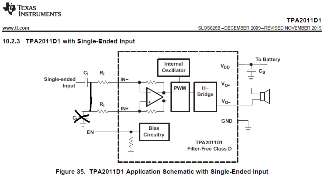

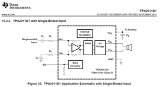

About the pop noise reduction method at the EN on of TPA2011D1.
Circuit specifications:
Single end, Gain 20.9 dB(Rin1,Rin2:27kΩ1%)、Fc=5.9Hz(Cin1、Cin2:1.0uF)
Power supply5.0 V, bypass capacitor: 10uF+1uF+0.1uF
Phenomenon:
Pop noise occurs when the EN is turned On from Off  at 2.0Vpp, cycle 15us.
I changed Cin1 and Cin2 from 1 uF to 0.47 uF according to the E2E forum.
However, pop noise still occurs 0.68 Vpp.
Questions:
Tell me how to lower pop noise when turn EN On from Off without changing the Gain.
