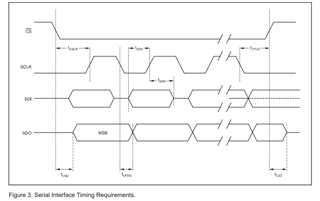

    is there a limitation how often SPI commands can be send to the PGA4311 per second?
    The limitation is determined by the timing requirements of the SPI protocol. You may refer to figure 3 and the electrical characteristics section of the PGA4311 datasheet.
