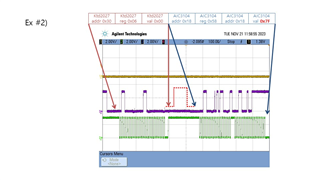

The thing is to have wrong read below.
You can see source part and osc- scope screen.
The register R88(0x58) must be 0x04. However 1st read shows 0x7F.
I added 2nd read for debug. Then 2nd read shows normal value.
I couldn't find why the issue happened.
At my source, after I replaced R88(0x58)  with other reg addr, I reproduced the issue.
The result show the same wrong value (0x7F) regardless of the reg address,
Can you advice why the issue happens?

    The reason to read wrongly  is related to another i2c device on the same I2c port of host device.
    Overlapping is
    - We write fm8802 bust with 712bytes.
    - And then we start reading and writing AIC3104 I2c around at the end of fm8802 bust write.
     In detailed view, I can see AIC3104 access between 2 or 3 bytes unit i2c with different i2c address(fm8802, ktd2027).
    The addr is 0x60(8bit address) . However, It's my fault. It is a different I2c device, led driver, ktd2027.
    That device address is 0x30, 7bit address.

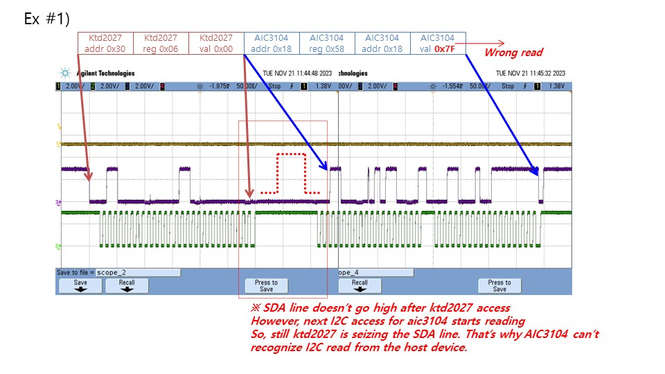

    - whether the SCL/SDA clock/slope are degraded by a resistor, capacitance by using OSC - scope, but I think it's normal level.
    - I blocked the SCL/SDA line of ktd2027 not to read ktd2027. The result shows regmap_read(..) returns -6("No such device or address") and show read failure. The data value show the initial value of variable that I declare.
    So seemingly, it seems that the regmap_read(...) for AIC3104 reads ktd2027.
    AIC3104 7bit address is 0x18, ktd2027 7bit address is 0x30 . It's one bit difference.
    However, I haven't found any hardwired issue or other software issue.

    I found new issue about i2c access between ktd2027(led driver) and aic3104.
    You can see two screes below.
    The issue is coincident with the condition case.
    When ktd2027 accesses the I2C, there is no stop I2C. SDA line is still low.
    At this time, AIC3104 start accessing I2C to read the reg of AIC3104.
    However, ktd2027 is seizing i2c due to no stop condition.
    At first, I was wondering why aic3104 can't recognize I2C read from the host.
    Now from this, I can understand the reason why aic3104 can't recognize i2c.
    Is there any idea about this ?

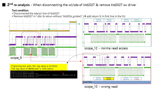

    Today, I checked more and tested below
    A. I disconnected the SCL/SDA of ktd2027
    B. I removed ktd2027 in linux DTS file and add return code in the ktd2027_probe(..) to remove the influence of host cpu;
    C. I have tested the different value when reading two times for the same register
    The result shows
    The issue still have regardless of ktd2027.
    When reading wrongly, regmap_read() returns 0(normal). However the value is wrong , 0xF8@0x58. It must be 0x04@0x58.
    And I can two acks pulse that seems wrong. On the issued i2c port, there is no same i2c address with aic3104.
    You can see the osc scope that I attached.
    And I also added scope raw data.
    Lastly, my ti driver source is added. Is there any additional config?
    Please advise me about this issue.

    I have the update for you.
    After two acks, reg addr is not 0x58. So I think that one ack of two acks is not ack.
    Maybe its short on sda line? please advise me about this .
    Many thanks
    BH

    By the way, I'm sending new analysis. You can see two sheets(*.pdf) from the attached.
    1st sheet is the doc that I sent before. the reg byte with two acks is 0x18. Actually the reg addr that I intended to read is 0x58.
    For the issue, tlv320aic3104 outputs the value of 0x18. All reg values matchs with the value of0x18 reg.
    In this case, I have tested with ktd2027, led driver unloaded. (or disconnected the scl/sda of ktd2027) .
    Seemingly, tlv320aic3104 wrongly outputs. Or the device mis-recognizes the reg address for some reason.
    You can see the case #1 sheet (2nd sheet) . The sheet shows the details.

         2-2) after blocking ktd2027, when reading 0x58 reg from tlv320aic3104, for some reason, the read value is the value from 0x18 reg.
                In this point, 0x58 is one bit difference from 0x18 tlv320aic3104 device address. (it's reproduced only 100~200 times test).
               So after changing the reg address instead of 0x58 into 0x11, the read value is normal. (no error from 1000 times test)
                -->  relevant testing data is "i2c_conflict_tlv320aic3104_itself.zip

    As I mentioned before, when ktd2027 access i2c , tlv320aic3104 also access i2c at the same time.
    At first, basically I can't understand this, because they are using the same i2c port. So I think that i2c has the locking system to seize the i2c.
    2ndly, you can see below that I already uploaded on this ticket.
    When ktd2027 doesn't release the i2c, at that time, tlv320aic3104 starts accessing i2c (read).
    tlv320aic3104 reads wrong value (0x7f) . It's another issue

    So I blocked ktd2027 temporarily. In that case, tlv320aic3104 reads the value of 0x18 reg address instead of 0x58 register.
    It's one bit difference . seemingly 0x58 reg address is one bit difference from 0x18 device address.
    Of course, this test shows the 0x18 is the register address.
    4th, I changed the reg address 0x58 into 0x11 (many difference from 0x18 device address)
    Then the result shows normal value ( the value of 0x11 reg )
    When I check 3rd issue result, tlv320aic~ device address(0x18) has one bit difference problem.

    By the way, below issue is tlv320aic3104 itself.
    As I said before, scl/sda disconnected and doesn't load ktd2027 driver (remove dtsi file) and blocks initializing ktd2027. --> double checked
    If I read 0x58 register in tlv320aic3104, the result is the value of 0x18 register . I double checked this issue after writing a few values to 0x18 register.
    0x58 reg is one bit difference from 0x18(tlv320aic3104 device address). So I have tested this after changing other reg instead of 0x58.
    Register is not one bit difference like 0x11. Then the problem is disappeared.
    So in conclusion, I think there is a issue on tlv320aic3104 driver.
