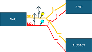

We are now having I2C SDA stuck issue on AIC3109. When issue happens, SDA is pulled-low. (SCL is high normally.) In our system, I2C structure is Master (SoC) <-> Slave1: TAS6424E-Q1 + Slave2: TLV320AIC3109-Q1. When we tried to disconnect the SDA between AIC3109 and system, system's SDA back to normal (voltage high). The SDA of AIC3109 is still short to GND. (pull-low by AIC3109 itself.)
Q1: According to measurement below, if SoC start to send I2C register to TAS6424 before AIC3019's reset is pull-high, will it make AIC3109's I2C SDA stuck? Should SoC start to send I2C "after" AIC3109's reset is pull-high?
(CB means AIC3109, AMP means TAS6424. I2C starts to have transmission in D6, D7 before D3 AIC3109 reset pull-high.)

    Q1:
    I2C bus should be able to drive at least 2mA in the low level state and 20mA in the high state.
    Here is what is considered high to the device for AIC3109. This value is given under digital input/output of TAS6424E-Q1 datasheet as well.
    That being said what is the voltage measured at the pin and IOVDD when SDA is stuck. Also what is the resistor value?

  • Unfortunately yes, the toggle of SDA from the Master during RESET can impact read/writability. If there is no overlapping in the sequence I2C transmission to other devices should not impact AIC3109.
