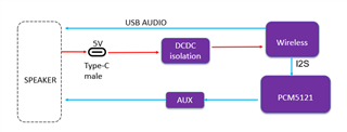

hi,team:
     here is an application. if without DC to DC isolation(ground separation). the AUX out noise is big( usb audio don't work).
     my question is if usb audio works , the digital will use the aux path's ground . if this will cause the aux signal noise increase?
     do we have an aux path separation method so the digital and power ground will not disturb the analog audio path ?
     thanks a lot.

  • hi,
        i will describe the question in details: the box speaker has a type-c port and aux in port. the device get power and delivery usb audio to the speaker from the c port. also there is another audio path from the aux port, it's analog out to the speaker. the question is the ground loop from c port to aux port back to the speaker is big thus it can bring up a lot of noise to the aux signal.  i find a solution using TI's cc33410(a dcdc isolation power module) to break the ground loop. but another issue is the case needs usb audio signal back to speaker. the ground is broken. the usb audio signal can't find a reference ground. it must use the aux path's ground,  i suppose this will cause the aux signal becomes bad again.
  • In general one might tie several IC's GND to each other and then tie these grounds  at some point together or simply leave it as 2 grounds on the board if that makes sense. ( i.e, GDND and GNDA).
