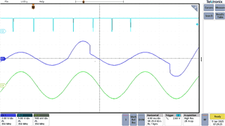

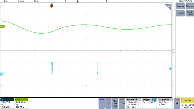

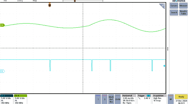

  • Hey Luis,

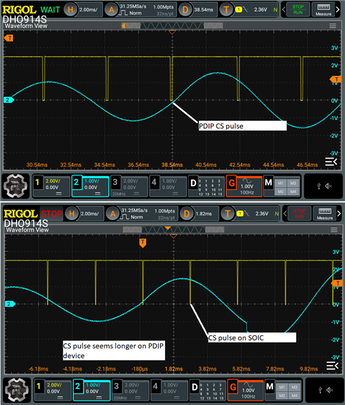

    here are some scope traces. For all traces Channel 1 (yellow) is the Chip Select of the SPI communication. Channel 2 (blue) is the output of the PGA2311. It is fed with a 100Hz 1Vpp sine wave.
    These two images are from the SOIC package. With only a single command the zero crossing detection works as expected.
    These two images are from the exact same device with exact same measurement conditions, but with repeating messages sent. These repeating messages contain a volume sweep. Every pulse on channel 1 is one message of the sweep sent. You can clearly see, that the zero crossing detection doesn't work all the time.
    And finally, these two images are from the PDIP package. This PGA2311 I just ordered from Digikey. The zero crossing detection works as expected with multiple messages sent.
    When listening to the output of the sweep of both packages it's like the waveforms suggest. The PDIP package is abolutely smooth, whereas the SOIC package is full of crackles.

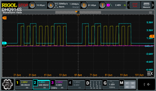

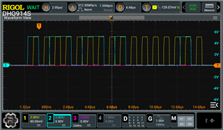

  • Hey Luis,
    here is the timing of the SOIC package. CS in purple, SCK in yellow, SDI in blue.
    This is the timing of the PDIP package.
    The timing is a bit different. The PDIP uses another micrcontroller without a FIFO, so there is a little break between the bytes. PDIP is also a bit slower, but as far as I see both are well within the timing constraints of the datasheet.
  • Hi Uwe,
    • I have reviewed the timing on the SPI interface oscilloscope plots above for SOIC/PDIP; and specs are met. SDI is changing state on the SCLK falling edge and read on SCLK rising edge.  On SOIC, SCLK frequency is about 1 MHz which is well within spec. tSDS, tSDH, tCSCR, tCFCS specs are met. No obvious issue on the SPI sequence on SOIC or PDIP
    • I have not been able to reproduce an immediate issue with the PGA2311 devices at hand. Nevertheless, I plan to spend additional time later this week and attempt to duplicate the timing on SOIC as close as possible (within the limitations of the SPI driver used on my setup). I am still waiting for new/fresh PGA2311 SOIC devices. I expect to receive within the next 2 business days; and perform additional tests by the end of this week.

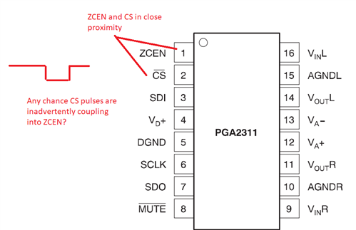

  • HI Uwe,
    If possible, one quick check/question regarding the PGA2311 SOIC solution,
    Is the ZCEN driven high with a GPIO or pull-up resistor? Or is this permanently connected to the VD+ supply?
    Can you kindly verify/check with the oscilloscope for low voltage transients/glitches on the ZCEN pin by placing the oscilloscope probe right on the ZCEN pin?
    On the oscilloscope plots on the post above, the unexpected non-zero crossing gain changes always occur somewhat randomly, but always shortly after the CS pulse after what appears to be a constant delay.  Since the CS pin is in very close proximity to the ZCEN pin, any possibility that the CS pulse signal (or perhaps any other external noise signal source) is coupling into the ZCEN pin producing a glitch on the ZCEN voltage?
    Thank you and Kind Regards,
    Luis

  • Hey Luis,
    good point with the CS coupling into ZCEN. I checked, but not a tiny bit of coupling measurable. It is pulled up to 5V with a 2k2.
    About your measurements: I only see the first message on the trace. The problem only appears though, when a second message is sent, before the first zero crossing.
    I have five of the problematic chips left. Would it be of help, if I send one over to you?
