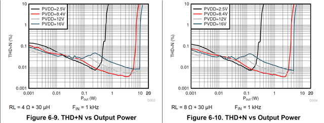

1. The two curves of Efficacy vs Output power and THD+N vs Output power in the TAS2563 datasheet are as follows:
Please provide a curve chart of PVDD=5V. If not, can you provide the efficiency and THD+N of PVDD=5V at 2W?
2. We would like to confirm whether there is any problem with the thermal boost of TAS2563. Is there any actual thermal test data of 6.1W or 5W for our reference?

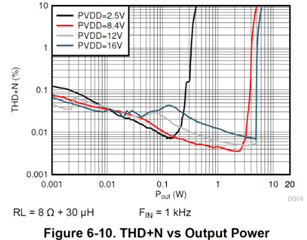

  • Hey Hopper,
    I was able to generate power efficiency plots to show performance for PVDD=5V.
    VBAT=3.8V, PVDD=5V, IOVDD=1.8V, VDD=1.8V, RL=8Ohm.
    I would like to mention that PVDD= 5V on 8Ohm load would generate a Vrms=3.535V and Pout=1.562W. These are to be considered values for measurement in ideal conditions.
    The DS doesn't have a plot for PVDD at 5V like mentioned but consider the performance to be between the plots for 2.5V and 8.4V. If you notice the trend of performance, efficiency increases with lower PVDD voltages. Assume the same for the 4Ohm load plot.
    Here is a THDN vs Pout sweep using PVDD=5V. Based off the trend presented in the DS, this performance is within expectation of a curve between 2.5V and 8.4V as well.
    None of these tests are specified by the DS but if you follow the trend presented from lower to higher PVDD, these plots I presented follow the trend.
    This should be able to clarify there are no issues with ext. PVDD at 5V. Although, PVDD=5V could still be achieved in non-bypass mode where boost is enabled to provide the voltage needed on the output.
    Feel free to share your end equipment. I'll consider this thread resolved.
