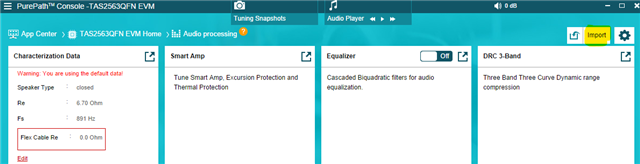

  • Hi, Ivan.
    I tried two things.
    I tried reading 0x24~0x29 "Latched Interrupt Readback".
    The value of 0x24 was 0x04, the value of 0x27 was 0x80, and the value of 0x29 was 0x80.
    The three events that may occur are TDM clock error, Device power down flag hold, and Clock halt flag.
    I installed the app for the QFN package and output a binary file in its default state without changing the sound quality or speaker characteristic information.
    When I wrote that file to the TAS2563 on the board, sound started coming out normally.
    I have a question. Is it possible to use the app for the QFN package to adjust the sound quality of the YBGEVM, determine protection characteristics, evaluate speaker characteristics, etc.? Or, after performing these tasks using the app for the YBGEVM, can that information be transferred to the app for the QFN?
    I look forward to your reply.
    Fumiya.
  • Hi Fumiya,
    Good to know the new configuration files work better.
    You can try using the import function on the QFN app. I'm sure not all the features will be able to sync but I think you can at least import the speaker characterization.
    -Ivan Salazar
