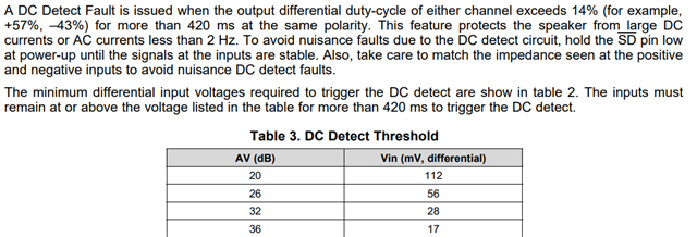

    A possible scenario could be a DC detect fault happening which will reported on the fault pin as a low state. This causes the device to shutdown and turn the outputs to Hi-Z. To clear the DC detect fault, you must power cycle PVCC.
    Here's a snippet from the datasheet that describes how a DC detect fault is triggered.

  • Hi Dream,
    The DC Detect Threshold table refers to the voltage differential between the positive/negative audio inputs.
    Cycling the SD pin won't work if it is a DC detect fault.
    Could you possibly probe the inputs on the boards where this is is occurring to see if there is a voltage differential equal to or greater than 112mV for 420ms (min duration) ? This would trigger a DC detect fault.

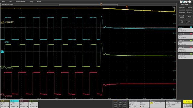

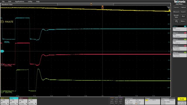

  • Hi Sebastian
    At an ambient temperature of 60°C, 3 PCS were tested for 2 weeks, and 1 PCS had a problem.
    The following is the waveform measured when the problem occurs.
    When measuring OUTPL and OUTNL with a multimeter on a problematic board, there will be a voltage difference of more than 0.3V, while a normal board will not have a voltage difference.
    Is this the problem that causes the DC detection abnormality?
    Thanks.
  • Hi Dream,
    Thanks for providing the scope shots. Yes a voltage differential across the OUTPL and OUTNL pins of 0.3V would certainly trigger the DC detect fault. Below are the thresholds:
    Were any of the passive components connected to the output pins damaged on the problematic board?
