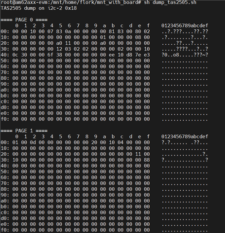

TAS2505: The TAS2505 device produces noise when playing PCM audio data.
Part Number: TAS2505
Other Parts Discussed in Thread: AM62A7
SOC: AM62A7
SDK ver 10_00_00_08
clk_mcasp1_fixed: clk_mcasp1_fixed { #clock-cells = <0>; compatible = "fixed-clock"; // clock-frequency = <24576000>; clock-frequency = <12288000>; };

sound { status = "okay"; compatible = "simple-audio-card"; simple-audio-card,name = "AM62Ax-tas2505"; simple-audio-card,dai-link@0 { format = "i2s"; bitclock-master = <&sound0_master>; frame-master = <&sound0_master>; sound0_master: cpu { sound-dai = <&mcasp1>; system-clock-direction-out; };
codec {
clocks = <&clk_mcasp1>;
sound-dai = <&tas2505>;
main_mcasp1_pins_default: main-mcasp1-default-pins { pinctrl-single,pins = <
    AM62AX_IOPAD(0x090, PIN_INPUT, 2) /* (L19) GPMC0_BE0n_CLE.MCASP1_ACLKX */
    AM62AX_IOPAD(0x098, PIN_INPUT, 2) /* (R18) GPMC0_WAIT0.MCASP1_AFSX */
    AM62AX_IOPAD(0x08c, PIN_OUTPUT, 2) /* (K19) GPMC0_WEn.MCASP1_AXR0*/
    AM62AX_IOPAD(0x084, PIN_INPUT, 2) /* (L18) GPMC0_ADVn_ALE.MCASP1_AXR2 */ >;
&mcasp1	{
    #sound-dai-cells = <0>;
    pinctrl-names = "default";
    pinctrl-0 = <&main_mcasp1_pins_default>;
    status = "okay"; op-mode = <0>;	/* MCASP_IIS_MODE */
    tdm-slots = <2>;
    serial-dir = <  / 0: INACTIVE, 1: TX, 2: RX / 1 0 2 0 >;
     tx-num-evt = <32>;
     rx-num-evt = <32>;
Based on the provided registers, schematic, and device tree, there is some audible noise that is interfering with normal PCM audio playback.
PCLK=5.6M MCLK=44.1k
