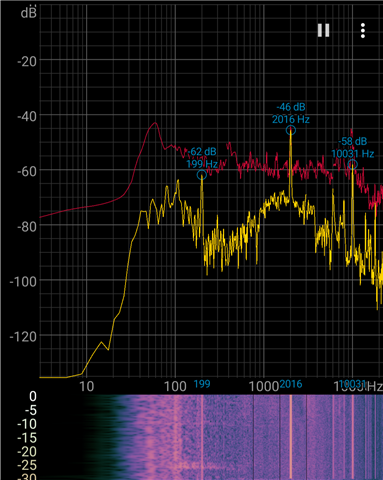

    Here a sound spectrum shot (from my phone) when I use the beep generator feature to produce a 2000 Hz sine wave at the Class-D Speaker output:
    We can see a peak at approximately 2000Hz with -46dB power.

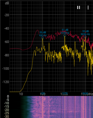

    When we send data of a sinus at 2000Hz to the DAC using I2S protocol:
    We can see a peak at approximately 1000Hz with -51dB power.
