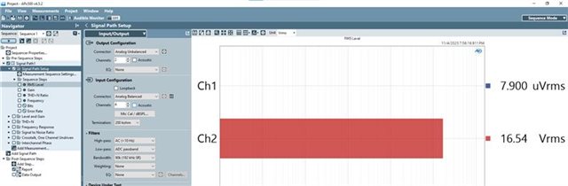

    I have tested the issue at multiple voltage levels for our ICM(Volvo) project
    At 24 volt input power supply.
    PDVV register value is 23.75 V as shown in attached screen short.
    Output voltage is shoring 16.50 Vrms
    Clipping is still present is at the full volume as shown in attached Screen short
    Speakerout Vrms
    RegisterPrints
    ClippingWave.
  • Hi
    For 24V power supply, you can't give too large volume, as the device will try to output 43V peak output for max input, will definitely clipping.
    Have a try to set Analog Gain in register 0x4A to 0x4D. Use the value 0x16.

  • Hi
    I have Tested with 15 volt power supply for debugging propose but still clipping is present.
    Please use 24V to test, otherwise you need to further reduce volume, or Gain.
    What is the maximum channel out put for 24 Volt input supply ?
    The max is just 24V peak sinewave.

  • Hi
    Could you please confirm if there are additional registers that need to be configured or modified to achieve the desired effect?
    Could you tell me what is your desired effect?
    Before developing the circuit, you should according to your PVDD voltage, target max output power, to calculate the max input level, also the Gain of amplifier need to use. Do you have all these number right now?
    The IC simply amplify your input with the Gain you set in the register. If such kind of clipping happens, it's either you raise your PVDD voltage, or decrease the input signal, or decrease the Gain settings. They should be calculated.
    Use oscilloscope to capture the waveform, capture the PVDD voltage also the Output at the same time. Observe the waveform, and do the changes that I just mentioned, to find the relationship with all these parameter.
