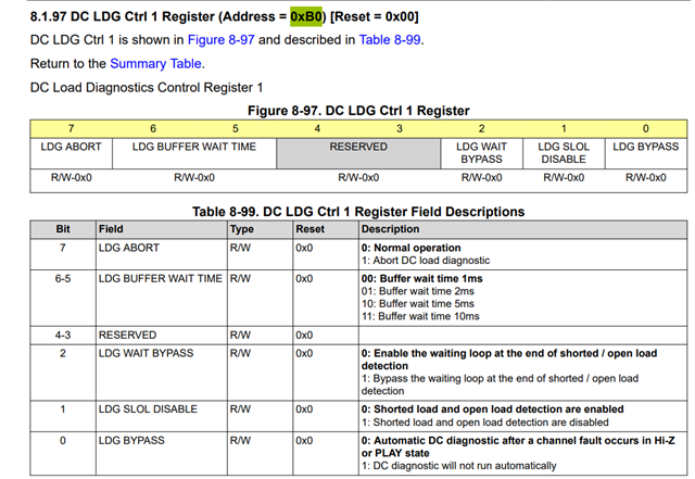

    (1) Could you please describe more on how to "use I2C to bypass DC load diag"?
    You can abort or bypass the DC DIAG by 0xB0 register. (bit7 and bit0)

  • Hello Wei,
    Thanks a lot for very detailed answer.
    Is the following understanding correct?
    "0xB0 register - bit0" can only prevent entering DC diag from Hi-Z / Play State, it cannot prevent entering DC diag from Load Diag State?
    Thanks.
    BR/Hao
  • Hi
    If you do Manual DC diag at register 0x03/0x04, device will still do the diag, 0xB0 register won't stop it.
