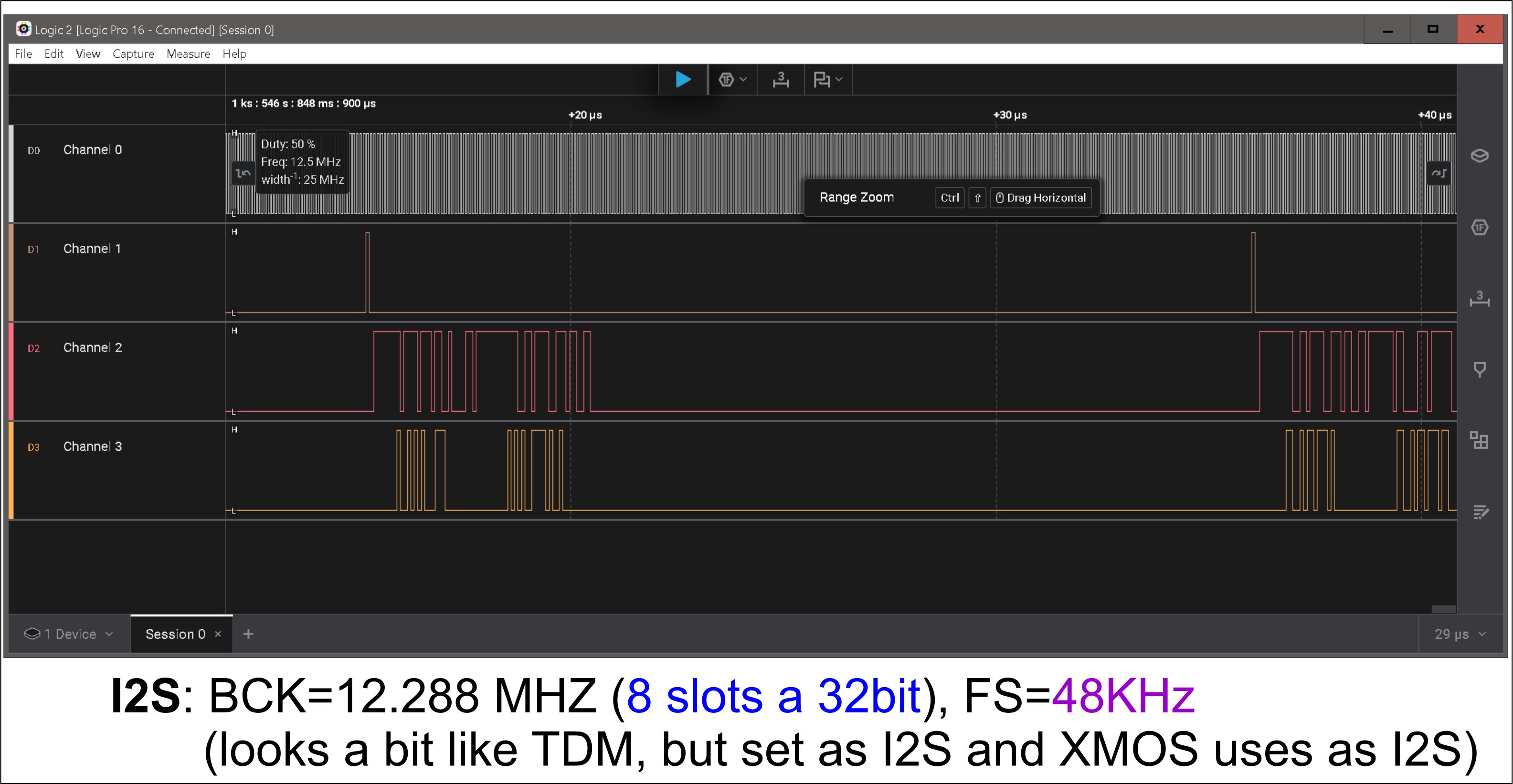

Here two waveform captures for I2S signals.
Strange is:
- configured as I2S but it looks still like TDM (FS is just a pulse, not stable during entire left channel, but OK, it seems to work)
   BTW: this I2S signal waveform is generated by the XMOS AC-MB (nothing to blame on TAD5212,
   running as a slave)
- even it seems to be handled properly by the XMOS AC-MB - it is still a 8 slot I2S signal
   (see BCLK as 12.288 MHz, FS as 48 KHz, as 8x32bit slots still)
Figure 1: I2S waveform (generated by XMOS AC-MB): 8 slot I2S with FS as a pulse (like TDM, but working as I2S setting and only if I2S is selected, XMOS does not seem to handle it as TDM)

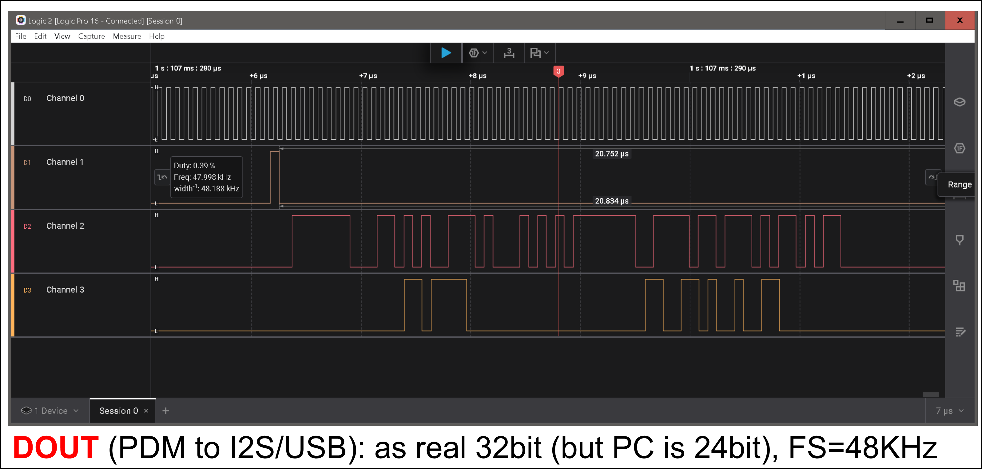

Figure 2: PDM in signal (channel 2, red): it is a 32bit I2S data frame!
My assumption:
The I2S timing generated is wrong (for PDM in, DOUT to USB). Or DOUT jitters a lot, does not come at the right time, is sometimes shifted by one clock edge (interleaving right and left channel values).
The USB drivers on PC uses 24bit, 48KHz (set as 2 channels for USB/DAC out, 8 channels for USB/PDM in).
The I2S to DAC is correctly a 32bit frame with 24 valid bits (OK, the LSBs are zero in 32bit data frame).
But the PDM in is also a 32bit - but now with all 32bits valid and used!
If this DOUT signal comes just a bit too late, with jitter, the LSB can go as MSB for the other channel.
This is what seems to happen (the PDM channel DOUT is not correct for the USB stream to PC).
This creates heavy noise, distortions.
If PDM MIC is set to 24bit - it is clear: obvious: now the lowests bits are also zero and even they would slip into next channel as MSBs - still OK (not setting MSB for other channel).

    The I2S signal generated (as illustrated) is still an 8 slot (x 32bit) signal. I use only the two PDM MICs on eval board (two slots and two ADC/PDM channels).
    As I understand (see also the setting for the USB to Eval DIN, coming out on DAC): it has to be set as: left slot 0 and left slot 1.
    Makes sense for an I2S frame (when FS signal covers 8 slots!): so, now left and right I2S data words come as on "regular I2S", after each other,
    as lost 0 and slot 1 after FS triggered.
    I assume I "should" to set also for MIC to USB host (as I2S DOUT, Tx channels in TAD5212) in a similar way (reg. 1E=20, 1F=21), left slot 0 and left slot 1,
    so that the first two slots are used (as on I2S).

    Detailed analysis and my conclusion:
    It looks like something is wrong on the DOUT timing (for the ADC/PDM to I2S for USB):
    • the setup and hold timing for the DIN (from USB PC to DAC) looks perfect - OK
    • but the setup and hold timing for the DOUT (to PC) looks strange, esp. on the MSB bit!
    • if the MSB on DOUT "jitters" - no wonder why I get so much noise (and still part of the signal sounds correct underneath the noise)
      (a randomly "jumping" MSB creates a half-swing amplitude noise - what I hear)
    Figure 1: DOUT and DIN on AC-MB as same signal - OK
    Figure 2: DOUT (on MC-AB) as ADC/PDM via USB to host
    Figure 3: DOUT looks a bit shifted and "too late"?
    Figure 4: actually, the MSB of DOUT seems to "jitter" (very short hold time here)
    Figure 5: the MSB of DOUT seems to be always "at the corner"
    Figure 6: the hold time of DOUT is just 8 ns - maybe sometimes it come before the raising edge of BLCK?
    DOUT looks completely different in terms of setup and hold-time in relation to the DIN signal.
    If DOUT "jitters" and the MSB is sampled wrong - heavy distortion (and noise)

    w a0 1a 30 #0x30 for MIC USB in, 0x70 for USB out !!!!! it sets TDM mode (not I2S)!
    w a0 26 01  #DAC out TDM with one clk shifted!
    w a0 1e 20 #PDM MIC slot
    w a0 1f  21 #PDM MIC slot - STRANGE! - why 0x30? not 0x21 - must be 21

    "if you configure TDM - and you want to sample/use as TDM - the DOUT (PDM to I2S) will not work"
    (this data line should now delayed by one clock cycle and TDM never working).

  • Hi Torsten,
    Apologies for not catching this earlier, but I see the issue clearly now - and it is due to the XMOS, not our device the TAD5212. The XMOS cannot recognize the true I2S protocol with left and right channels - it can only interface with TDM as you noticed.
    Because of this, to send audio via USB, you will have to configure the TAD5212 in TDM mode. Also, the XMOS introduces a one bit delay on its DOUT, which is why the RX OFFSET must be set (register 0x26 = 0x01) as you found.
    So this is not a bug in the chip, but rather accommodating for the limitations of the XMOS.
    In order to use configure the device with I2S mode, you must supply the clocks via the External ASI pins on the bottom edge of the AC-MB.
    Garret
