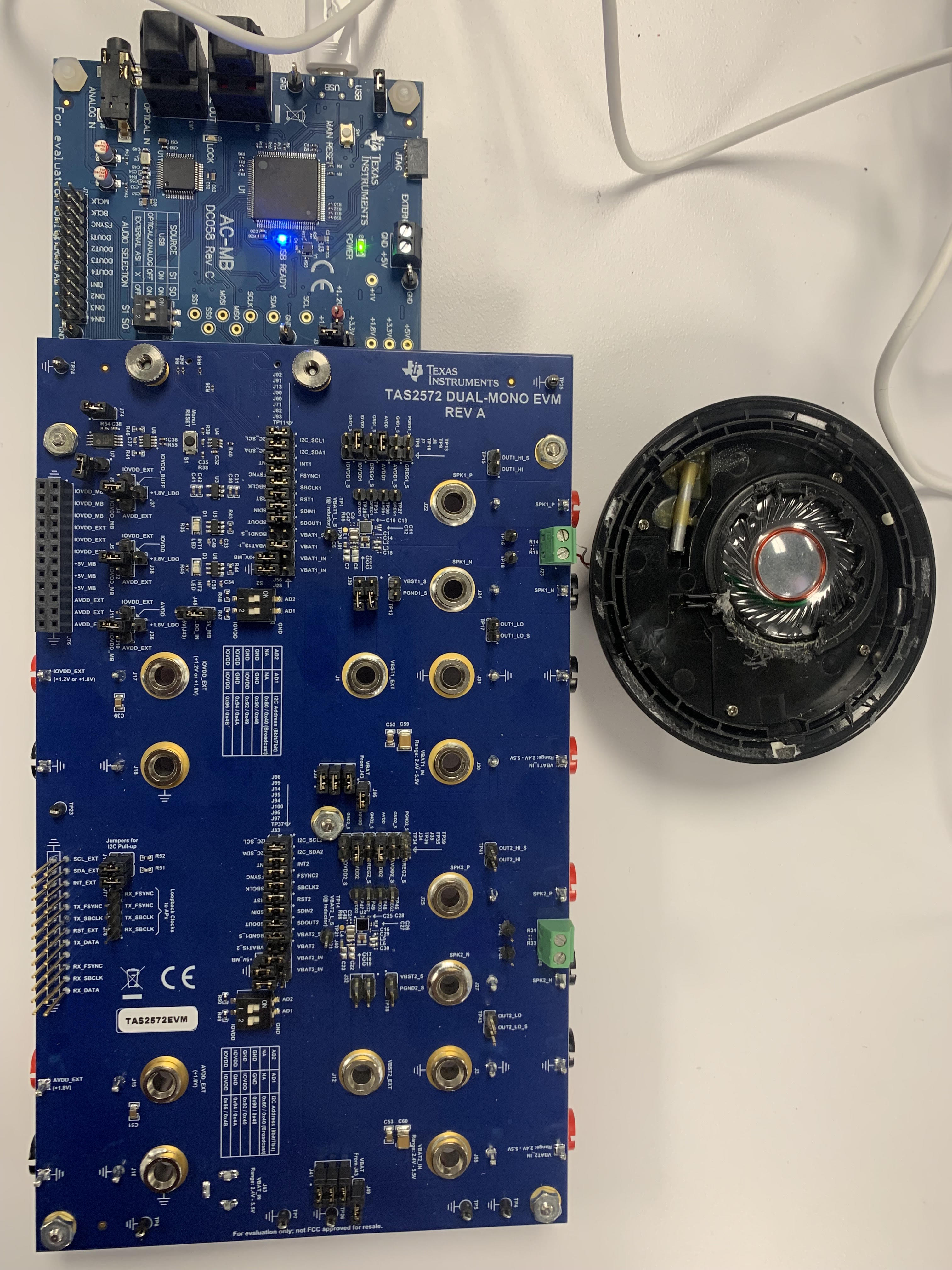

I am trying to bring-up the TAS2572 Dual-Mono EVM (Rev A) board with a AC-MB DC058 (Rev C) and not successful. The USB READY led is blue and the TI Audio sound card is detected successfully but no audio is playing.
I have not configured the Amp using PPC3 Console yet. I was assuming there must be a defualt config but I may be wrong.
Can somebody take a quick look at the jumper settings and comment? There is no external power supplied to the TAS2572 board. (attaching the pic of the board)
Thank you. Appreciate your support.
  • Hi Raj,
    TAS2572 need some init command to power on the chipset. you can use PPC3 tool to control the chipset.
    and the EVM board's jumper setting should be OK to support the PPC3 tool's communication with the board. after the init, it should be ok to play out sound. but as the MB power usually is no enough for the larger speaker to work in rated power, it's better to use external vbat to driver the speaker for higher output power.

  • Hi Raj,
    It seems you met OC issues. so the device will shutdown itself to protect the device.
    normally, the J43 should be used to power the device. I will copy your settings first to see whether I can reproduce your issue. if not, I will share all my settings with you for your test.
    Br,
    Wenbin
  • Hi Raj,
    I can reproduce your issue if I didn't provide the VBAT_in.
    the vbat_in is the real power supply for the class-D(boost), if missing it, the device class-D will not be powered and will results in some issues.
    please add power to J43 (or J55/J30, current jumper setting connect the 3 power input together), then your board will work with de default PPC3  settings.

  • Adding the setup pic w/ new 8ohm speakers connected.
  • Hi Raj,
    it seems the connection is ok, only one reminder: the power supply should be stable.
    if you still meet the the OC issue which is similar to the vbat absence. please check the following thing:
    1 remove speaker, and then play the music, check whether the OC occurs
    2 use speakers. but use very low signal level, such like -60dB.
    Br,
    Wenbin
  • Hi Wenbin,
    Good News! It works with J43 power and when the signal level is lower than -30dB. It hits OC if the level goes higher.
    Thank you so much for your support.
  • Hi Raj,
    in this case, it should be the power supply's capability or the wire's length. I usually use 5V 6A power supply. you can try it if possible.
    Br,
    Wenbin
  • Hi Wenbin, Thank you so much for your support. I have tried with 5V, 3A power supply and was able go upto -20dB which is aligned with your assessment.
