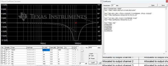

    I am curious if the all-zero filter has the effect you intend (no-pass)? You can use this tool to calculate coefficients for specific biquad filters at 8kHz FSYNC: https://www.ti.com/tool/COEFFICIENT-CALC
    I would try a 1kHz notch instead.

    I replaced the filter setting of the biquads of the record path with a 1kHz notch,
    and modified the TAC5212 configuration accordingly:
