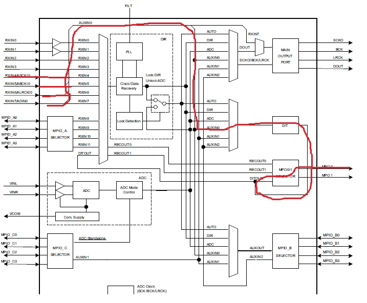

Hi everyone,
Sorry, I've read a lot of forum pages about the PC9211, but I haven't found a solution:
I've always used the PC9211 with an SPDIF input as a selector to send the desired input to MPO0. Now I'd also like to add an I2S input. My idea was to route it to AUXIN0, pass through the DIT, and always output SPDIF to MPO0.
What I always get at the output is a fixed clock, not an audio signal (even if I mute the registers).
I thought it was enough to set the following registers:
0x40 = 0xA0
0x60 = 0x33
0x61 = 0x20
0x62 = 0x00
0x78 = 0x0D
I'm also attaching the routing I wanted to do:
     can you confirm register 0x40 is 0xA0 or  (xC0) , the reset is 11000000  (xC0) . 10100000 as you have it is not the default. If this is not the issue or you have any other register beside the above, let me know and I will look into it more.
    Arash
  • Hi Arash,
    I checked all the registers and they are all default except the ones indicated.
    I reset register 0x40 to 0xC0 by default.
    The result is the same: at MPO0 output, I get a fixed 1.54 MHz waveform, whether I'm playing an input signal or not.
    If I read register 0x38, I see the correct playback clock (96 or 44.1).
    Stefano
  • Hi Stefano,
    I don't see any issue with the code above,  I suspect may be a register   is missing in the path.
    also verify  the correct format  of data and clks of I2S;  note that BCLK  has to be equal to # of Ch.  x   Ch depth  x  Fs.
    I have a few script for this device, you can start from one of them and do the above modifications/additions to the end of the script  to see if it helps .

  • Hi Arash,
    I did some testing.
    I also moved my input from auxin0 to auxin1 via MPIO_C, but the result was the same.
    However, I read about a standalone mode on MPIO_C, so I wanted to test it, and it works!
    I don't understand what was causing it to not work normally, though. I think it's something with the internal clock.
    In your example, you always set XTI, but is it necessary?
    Stefano
  • Hi Stefano,
    It is good you got it to work now. The beauty of this IC is that it has many different routing options.
    The PCM9211 uses the XTI source as a reference clock in order to calculate the sampling frequency of the incoming S/PDIF stream as well as one of the sources for the ADC and if PLL can not lock, the IC uses the XTI . Also when using the DIR as a clock source, the XTI source is not required. I think we set them up as general set up but might not be needed for all cases.
    Kind Regards,
    Arash
