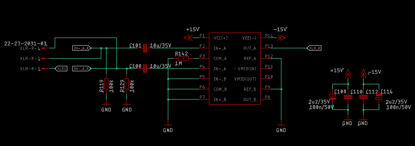

I’ve run into the same issue in two separate cases. In both of them, one channel stopped working after about 1–2 months. In both setups, an Eversolo DMP-A8 was connected via XLR to the amplifier input board. These were two different DMP-A8 units, not the same one.
a) First case: two INA1650 devices used for one input, with an additional 1MΩ resistor on COM_A. Power supply: dual ±15V.

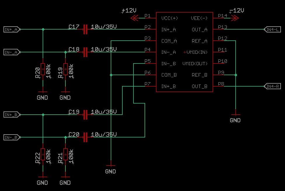

b) Second case: one INA1650 used for both channels. Power supply: dual ±12V. Here as well, one channel stopped working. After replacing the INA1650 with a new one, the same channel failed again.
Pin 1 of the XLR is connected either directly to PE (chassis) or to the chassis through 10 Ω + 100 nF as a lifted ground.
About the power supply:
For schematic a): linear power supply based on 7815/7915 with protection diodes.
For schematic b): two-stage linear power supply based on LM317 + LM337 with protection diodes, followed by a final stage using TPS7A39.
So it does not seem to matter whether the PSU is a classic linear design or a two-stage design using one of the best LDOs, the TPS7A39.

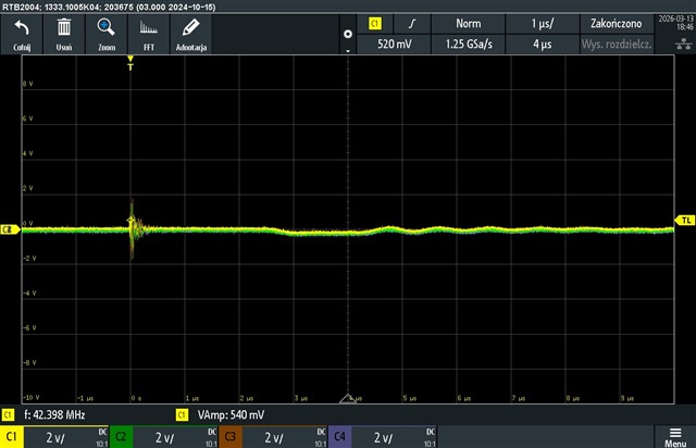

  • Hi Chris,
    Unfortunately, it’s difficult to capture on the oscilloscope. Once, during power-off, something was visible. It was tested at 1ms, 5ms, and 10ms, with 50mV, 100 mV, 200 V, and 1V settings. Maybe you could suggest other settings that would help us detect it more quickly, if anything is actually present? Additionally, the trigger was set to detect the falling or rising edge.
    What we did manage to measure was, of course, the DC offset, which looks quite interesting in the right channel:

    Additionally, one of the probes stopped working, so I’ll upload the full capture of both the positive and negative signals the day after tomorrow - a replacement probe has already been ordered. Today, I performed the measurements and tests using a single probe, switching it between the positive and negative signal of XLR while observing the behavior during power-on and power-off.
    Photo shows a 1kHz signal from USB source:
    image uploader stopped working so please check via this link -> https://ibb.co/6JvBvMY4

  • Hi Mateusz,
    You might try longer time scales such as 20us/div, 50us/div, and 100us/div (micro seconds) to see if you are able to capture any power up or power down transients. For the volts per division you may try 1,2, 5 V/division. I would try using the single shot mode on the scope and do the edge trigger on Ch1 pin2. If the scope supports math you can do Ch1-Ch2 in order to see the differential signal.
    Try power sequencing such as
    • A8 off
    • INA1650 Board off
    • Turn on A8
    Second test
    • INA1650 board on
    • A8 off
    • Turn A8 on
    Is the XLR cable ever connected and disconnected while the devices are powered on? This may be another potential cause for transient spikes.

  • Hi Chris,
    thanks to a friend’s help and his 4-channel oscilloscope, we managed to take some more measurements.
    The first measurement is of the left and right channels, with no oscilloscope ground connected - meaning only the “+” and “-” of both channels were connected to the probes, without the oscilloscope ground. The measurement was taken while plugging the Eversolo into mains power - the main 230 V supply. As you can see, there is a clear glitch on both channels at around 12V. (5V/div)
    The second measurement was taken with the oscilloscope ground connected to pin 1 of the XLR. The same test was performed - switching on the 230 V power using the switch on the back of the Eversolo unit. Scale: 2 V/div. There is less of it.
    So far, there are no additional effects when turning the unit on or off using the front button (the encoder). It is possible that the problem in the right channel occurs, for example, only once every 100 power cycles, and then there is one strong spike.
    Pin 1 of the XLR in the Eversolo is connected to... the RCA ground - in other words, to the ground of the entire power supply (not PE - chassis, just shorted withour additional resistor to RCA GND) and this GND also without additional resistor or RC to PE - chassis.
    To keep all the information in one place: pin 1 at the input of my modules is always connected either directly to the chassis PE, or to PE through an RC network (10Ω + 100nF).
    Mateusz
  • Hi Mateusz,
    Thanks for providing the information. I am not sure if a revision can be done on your board but if there is the possibility of large transient spikes that can cause electrical overstress we generally recommend using TVS diodes to clamp the inputs. We have a video training series that provides guidance on selecting these diodes that can be found under the electrical overstress section in the link below:
