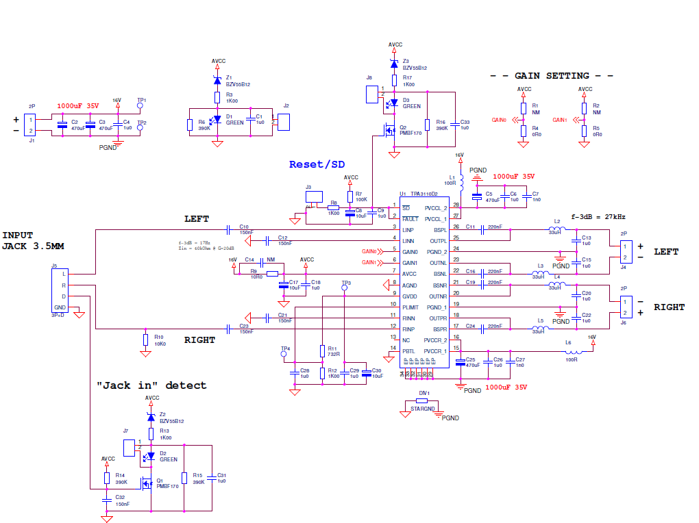

I'm using the TPA3110 for a 2x15W amplifier for my boombox. The datasheet states operating voltage from 8-26V. I'm unable to startup the circuit if the voltage is below 13,3-13,5V.. I can't find any information regarding UVLO in the datasheet. When the amplifier is turned on (above 13,5V input), the input can be reduced to 8V before it turns off.
Kind regards
CWilson.
  • The schematic:
    The 3 zeners (12V) are removed (12V+Vf_LED ~13,5V). I thought it was them which made the trouble, but they aren't.
    C8, C17 and C30 is removed.
  • Hi, CWilson. Thanks for using the TPA3110D2 in your boom box!
    The power-on threshold voltage for the TPA3110D2 should be around 8 V, not far off from what you're seeing for the power-off threshold.
    As you increase your supply voltage (the "16V" in your schematic), is the value shown on your power supply equal to the value measured directly at the PVCCL, PVCCR, and AVCC pins? If not, I bet something is drawing current as you ramp up the supply, keeping the amp from reaching the supply it needs. Are you able to put your supply to, say, 13 V, and see 13 V directly at the power pins of the chip and still not see the amp turn on?
    What happens when you remove Q2 and try to ramp the supply? Do you see the amp turn on at a lower voltage?
    Matt
  • Hi Matt,
    I measured the voltage the 3 places and it's 10.068, 10.068 and 10.053V (AVCC).
    I moved the upper SD-resistor (100k) directly to PVDD (16V) instead of after the 10R (AVCC). This didn't help.
    I removed the resistor R12 (lower resistor in PLIMT network). Now the AMP starts at  8V (or even a little bit lower).
    The PLIMT network draw 4mA, which was too much (7V/(732R+1000R) = 4mA.
    Now I don't have PLIMIT, which is OK because the IC will shut down if it gets too warm :-)
    /CWilson.
  • Hi, CWilson. Good catch on R12! Nice board sleuth work! You are correct that GVDD will have too much of a current pull on it with that resistor divider. Anything more than 2 mA can mess up the output FET gate drivers, which I bet is why you weren't seeing the amp start up.
    If you want to keep using PLIMIT (a good idea), you could always scale up your resistors R11 and R12 by a factor of 100. That would reduce the pull on GVDD and keep your chip starting up when it should. The PLIMIT pin cares about the voltage it sees, and as long as the resistor divider provides the same voltage as your old 732 Ω+1 kΩ case, you should have the same PLIMIT effects.
    Matt
