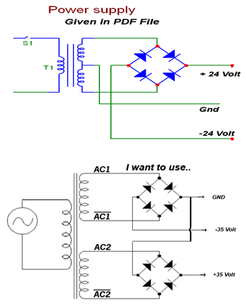

2Q. is it possible to use single primary & dual secondary (35V, 500VA per secondary coil) in Transformer instead of using 4 transformers 24V, 300VA for stereo? If yes what changes would be required?
(Note- I want to use double Power Supply for stereo but with single transformer)
3Q. Using dual rectifier instead of single rectifier, Will it be benefited?
(Note- in PDF file snaa057a, single rectifier with torrid transformer is used, but  I want to use dual rectifier with dual secondary transformer.)

    And yes you can use a single primary toroidal transformer with two secondries I will do the same.
    I think that's better to use only one bridge rectifier with an adequate heatsink. Connecting the two secondaries in series as in the datasheet of the transformer and you'll have the gnd (common) point.

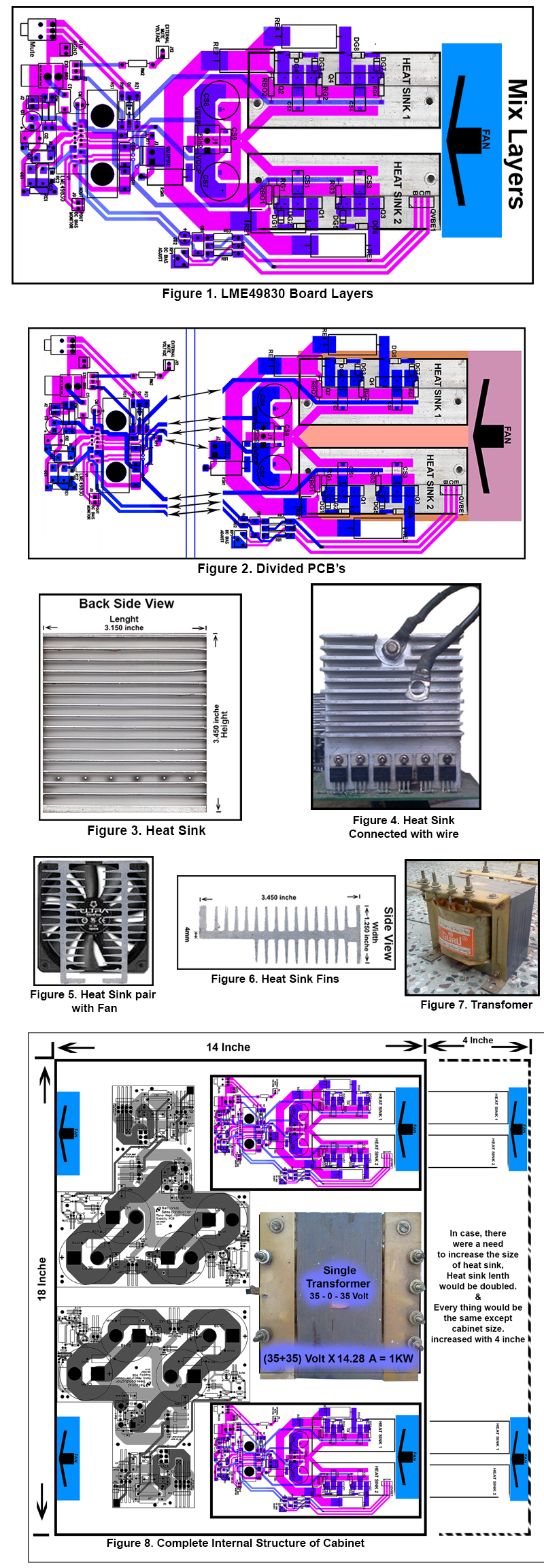

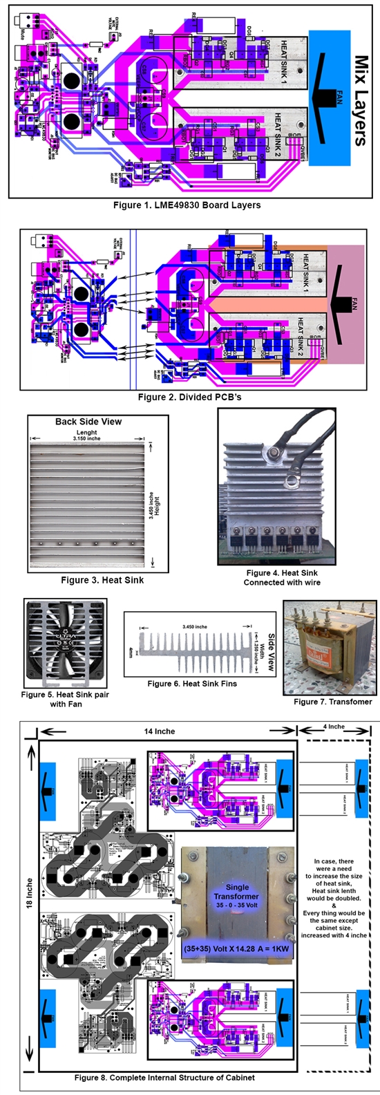

    I am giving you my whole plan, please verify it.
    My Questions
    Q. 1- Is my modified LME49830 PCB correct as shown in Figure 1?
    Q. 2- Is it possible to divide PCB into two part connected with two connectors (7 Pins). If yes, is there any need to add any extra components? Will dividing PCB increase any distortion in sound? Please have a look at figure 2.
    Q. 3- Is the heat sink size perfect? Or I have to increase its length as I can do this easily however it will also increase the size of cabinet. Have a look on figure 3, 5 & 6.
    Q. 4- Is it possible to connect VCC wire & VEE wire directly to heat sink 1 & 2? See Figure 4.  To make it more stable PCB. If Yes, Will it make any decrease in sound performance?
    Q. 5- How would I connect two power supply board with one Transformer? See figure 8.
    Q. 6- Is the position of all PCB's & transformer correct as given in first figure 8?
    Pankaj Kumar

    I had a quick look at your design. What output devices are you using?
    In general, you should avoid long traces to mosfet gates. Also the source resistors should be non-inductive types.
    In your design, traces to the gates are quite long, and  the source resistors -judging from the shape- are leaded wirewound types.  In combination with the very high openloop gain of the LME and the non-lineair gate capacitance of the fets this is an open invitation to severe HF oscillation of the output stages.
    For the source resistors, be shure to use non-inductive ( in fact really nothing is "non-inductive") low-inductive resistors. We use 4 or 5 thick film 1W smt resistors in parallel with goor results. Make traces between LME and gates as short as possible. Also traces to the temp sense transistor should be short. Keeping output feedback trace, gate driver traces and traces tot temp sensor short and  close together, this minimises stray capacitance, also because they all have the same ac signal. Best practice is to have the LME close to the mosfets ( < 1inch) or have the LME on the centre of the heatsink and the powermostfets located left and right next to the LME.
    success Geert
