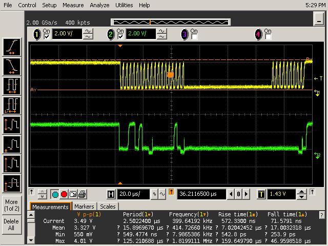

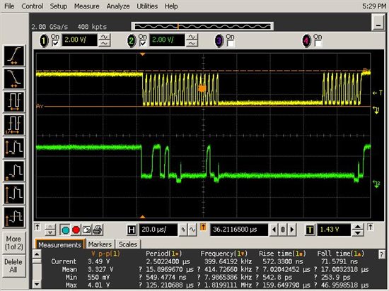

  • I can also confirm this behavior and I'm glad to see that we are not the only ones struggling with this.
    The difference is that we are using the TAS5760M. The amplifier is controlled and initiated via I2C by a processor. When our hardware is powered, the SPK_SD pin is pulled low and after it is initiated via I2C the pin is pulled high by the processor. However, when trying to communicate with the amplifier, the first I2C byte from processor after power on is never acknowledged by amplifier. It is always just the first that is not acknowledged. We have confirmed with oscilloscope that I2C clock and data is signaled as expected.
    From what I understand, some I2C slave devices need a "start byte" to wake up before it can receive any other I2C commands, but I haven't found anything about such byte in TAS5760 documents. This "start byte" is described here http://www.i2c-bus.org/addressing/.
    Here are a screen dump of the I2C bus where you can see that the amplifier is not acknowledging the first command after power on:
    Here are a screen dump of the I2C bus when sending "start byte" and where you can see that the first I2C command afterwords is acknowledged:
