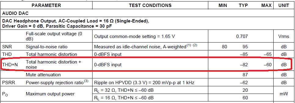

Although THD+N is mentioned on page 7 of TLV320DAC3101 data sheet, could you please tell us the measurement condition of this parameter for the dac headphone output?
THD+N was degraded below approximately 300Hz for TLV320DAC3101's specification when inputting with 0dBFS.
