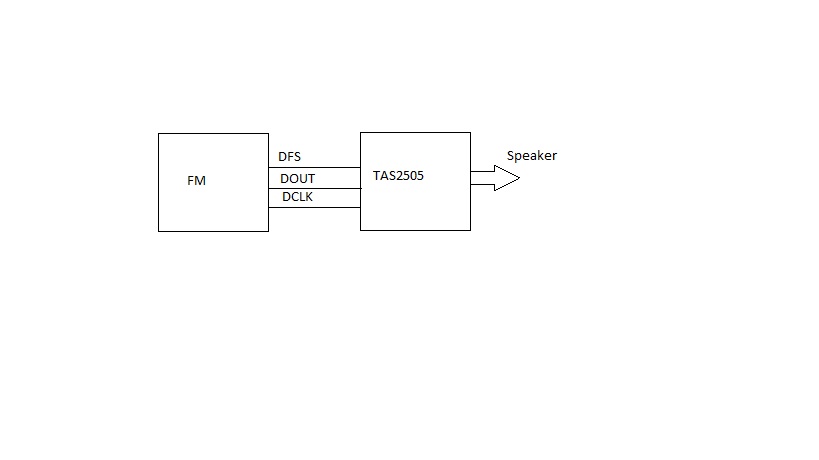

We are interfacing FM device(I2S slave) to TAS2505(Master I2S), we tried setting the audio configurations but not able to generate BCLK and WCLK pulses, please help us in doing audio configurations as BCLK and WCLK should be generated from TAS2505(Master) with 16 bits data word @ 32-44kbps clock speed.
