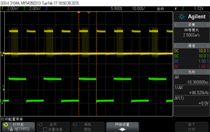

  • HI,The above picture is TDM mode.The yellow one is DOUT, the green one is LRCK.
    The parameter is as follows:
    a.PCM1865 as a Master
    b.48K sample rate
    c.four channel capture
    d.TDM mode
    However, even if I set the duty cycle of LRCK is 1/256, it is still 50%.And there is no output on DOUT.
    This one is I2S mode,The yellow one is DOUT, the green one is LRCK.
    b.48K sample rate
    d.I2S mode
    However, there is only TWO channel input is effective. When I insert a audio jack into 1R or 1L,the signal will change as the picture shows, BUT if I insert the same jack into 2R or 2L,there is no response on DOUT pin.It seems that this is only a TWO channel capture.However, the device I use is PCM1865, and register 0x71 is 0x10, indicates that it is four channel capture.

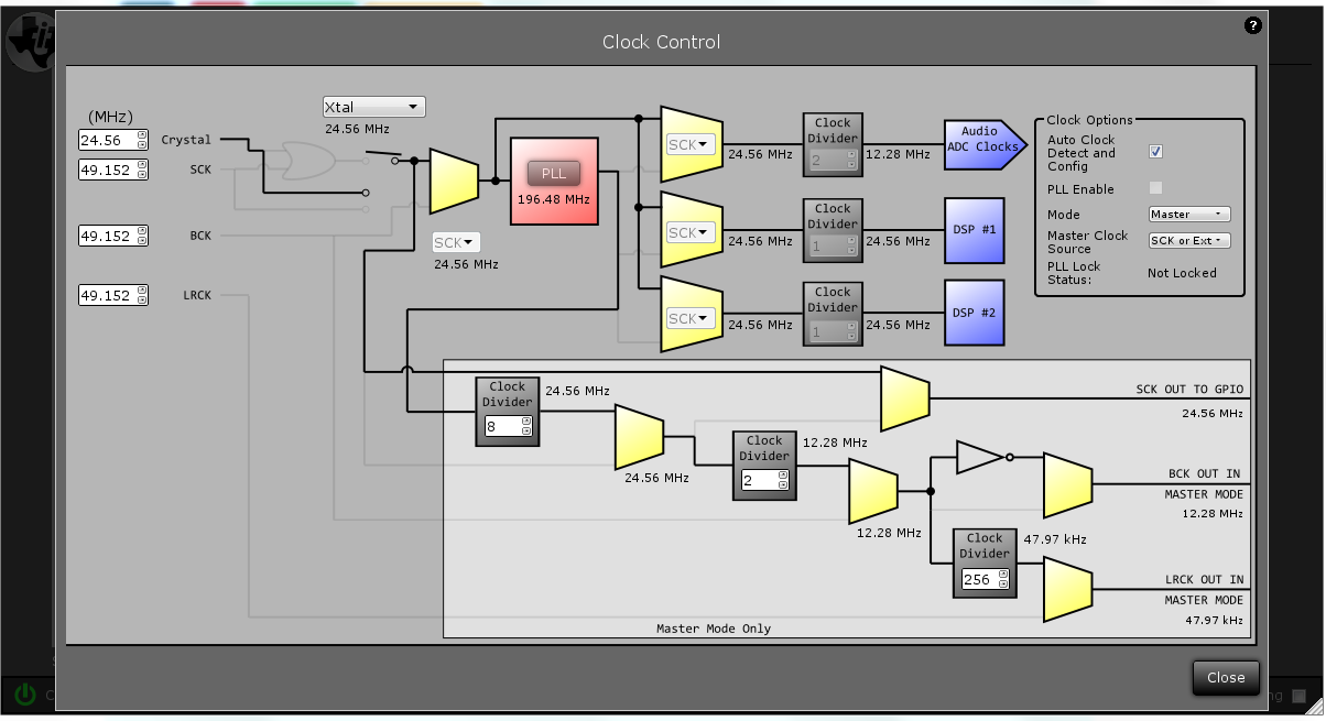

    So I was able to get TDM working in both master and slave mode. The salve mode could work with both 50% LRCK and 1/256 LRCK, however master mode only worked with 50% LRCK. Since what matters is the rising edge then this can still work.
    My procedure to get the EVMs working in TDM master mode:
    1. Plug in EVM USB
    2. Select mode 1, set jumpers, hit ok
    3. Set your clock dividers like the following:
    4. Next go to the Audio interface and set the Audio Format to TDM and select how many channels you want output.
    5. In this same menu you can change the TX offset or RX offset.
    6. I was also able to get all 4 GPIO options outputting DOUT2 by setting the GPIO to output, then setting the second option to DOUT2, these pins were INT, MD6, MD5, and MD4.
    7. Note that the 24 bit output for TDM will be 24 bits, without the 1 bit offset of I2S and there are no padding bits with each word. This means that each word is 24 bits exactly not 32 with 8 bits of padding like in I2S. The outputs will also be HIgh Z when not outputting a word so that other devices on the bus can drive the line.
    I hope this helps, if not please let me know what doesn't work.

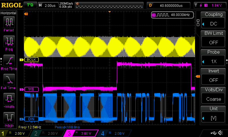

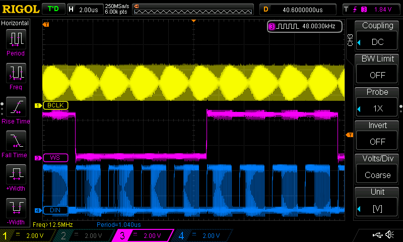

  • I met the same issue.
    PCM1865 master mode, TDM output format, set Page 0 Register 0x0B bit 4 (TDM_LRCK_MODE) to 1, the duty cycle of LRCK is still 50%, and what's worse, channels 5 ~ 8 output data are corrupted.
    As a reference, when Page 0 Register 0x0B bit 4 (TDM_LRCK_MODE) = 0, the waveform is correct.
  • Hi Xing,
    The PCM186X in master mode, LRCK can only operate in 50% duty cycle mode. However if you want a use a system that wants a 1 bit pulse, they usually only care about the rising edge, so the 50% duty cycle can still work. So when the PCM186X is the master in master mode you must use the 50% LRCK mode.
    Justin

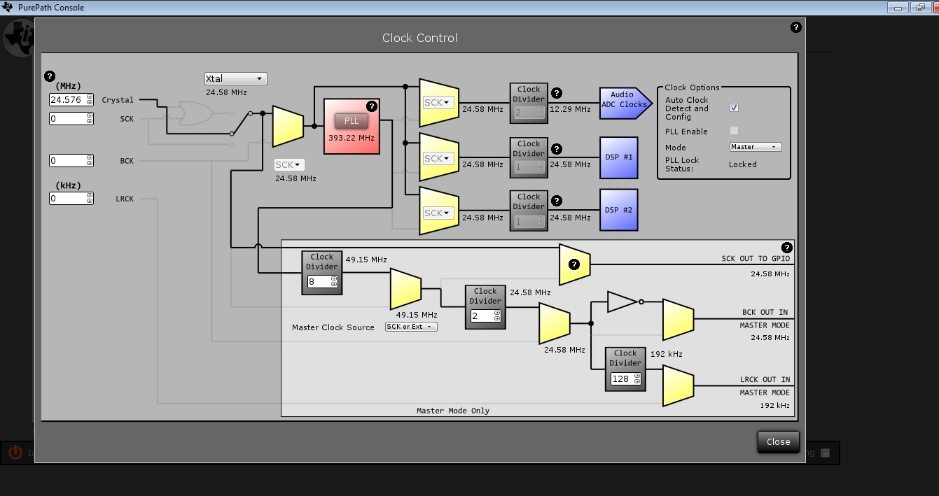

  • Hi Justin Bohr,
    Thank you for your Information on TDM4. It has been very useful for  1/256 ratio.
    But our requirement is 1/128 ratio. when I config for this ratio data is not coming out.
    Is there any possibility for getting 1/128 ratio?
    Please Help Me.
