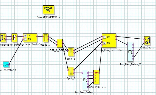

I want to add delay about 300ms for my audio application. Is it possible?
Pictures depicted below are my current process flow and I manage to achieve about 128ms.
If I put size7+size1>700, then I got output error. Is there any limitation of the delay? Any help would be much appreciated!
