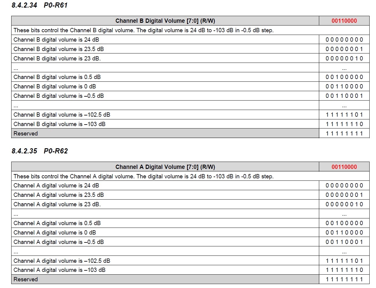

  • Hi Kato-san,
    I think you are talking about the digital volume on channel A & B, right??  You don't need to switch buffers to do that.
    Below are the registers that are used to change the digital volume for channel A & B separately. I have already confirmed that using a TAS5754EVM.
    Andy

    Thank you for your prompt reply and sorry for my misunderstanding.
    I understood that it is not necessary to write 0x05 to P44-R1 if changing the digital volume.
    Then, I have an additional question about P44-R1 register.
    Is it necessary to write 0x05 to P44-R1 after changing which registers ?
    Could you please tell me how to use P44-R1 register ?
    Kato
