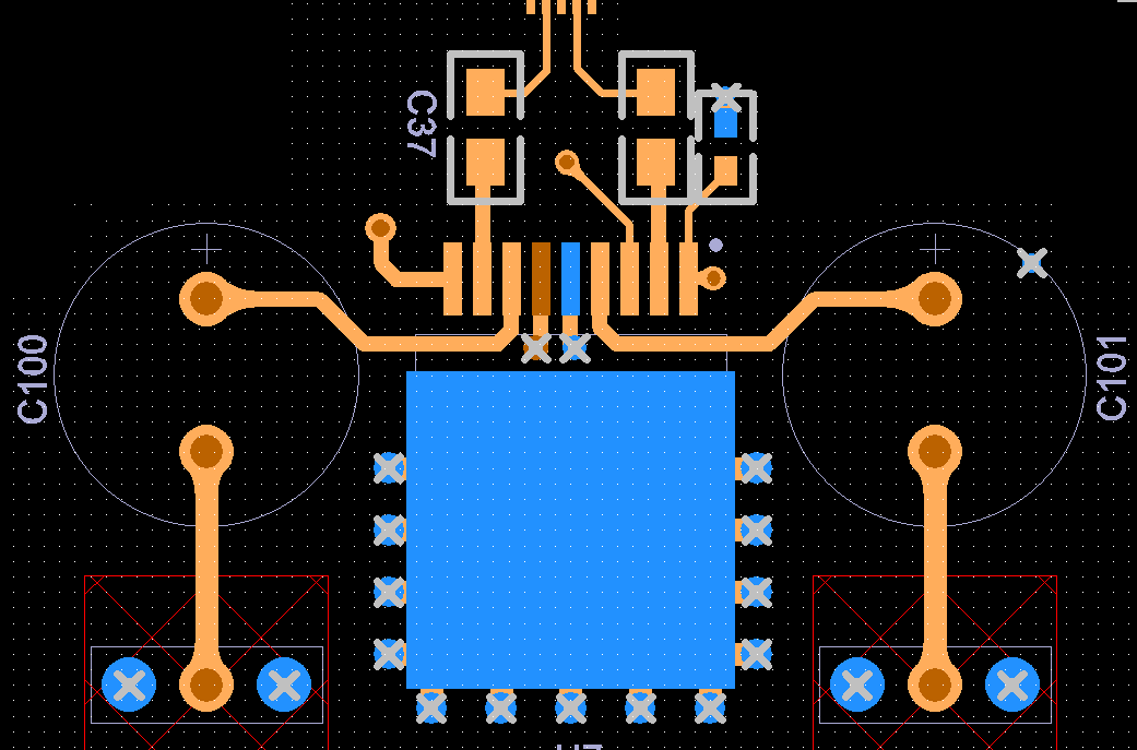

I have a problem with my audio power amplifier circuit :
When i power this circuit for the first time (system being off for a long time) everything is O.K. but if i reset input power , amplifier starts again after a long delay (about 2 minutes) and then there is loud "pop & click" at outputs.
Load speakers are 3W and 4 ohm.
Speaker P/N is : AS07104PO-WR-R from PUI Audio Inc.
*Speakers are always connected .
*Inputs to this amplifier is coming from an analog switch which change audio path to this amplifier or external amplifier .
*During this transition speakers are completely silent and there is no noise at all.
Can you help me to fix this problem ?

  • This is PCB Layout for Top and Bottom :

  • Hi Molla,
    I apologize for the delayed response.
    Your layout seems to be pretty much in line with the recommended design from the datasheet.
    The turn-on time is effectively related to bypass capacitor and the pop and click reduction, although you're using the recommended value for this capacitor.
    Have you tried a turn-on/turn-off procedure?
    For turn-on: Power-on the supply while the device is in shutdown, when the supply is stable then take the device out of shutdown.
    For turn-down: Shutdown the device and then power-off the supply.
    -Ivan Salazar
    Texas Instruments

  • I think I've found the problem source :
    I've traced BYPASS pin and saw that when I put probe on it, the voltage goes down to almost 1.5V . This maybe is not a problem but
    I had noticed resetting power when BYPASS voltage is zero cause no problem as said in data sheet all capacitors must be discharged during
    power up . So how can I make sure this capacitor is fully discharge during power-up ? Is there any recommended circuit ?
  • Hi Molla,
    Sorry for the late response.
    You could try to add a resistor to discharge the Bypass capacitor while the device is in shutdown. It is not recommended to keep the resistor connected to the Bypass pin when the device is operating as this could affect the Bias reference voltage.
    -Ivan Salazar
    Texas Instruments
  • You mean for example a MOSFET parallel to BYPASS CAP to discharge it to GND ?
    Some experts giving me an idea included a diode connected to +12v at cathode and BYPASS at anode .
    Any suggestion ? I need a practical solution.
    Thanks for your support.
  • Molla,
    I mean a resistor in parallel with Bypass cap to discharge it, it could be connected through a transistor to avoid the connection of the resistor when the device is operating.
    The diode could also be a solution, I think this solution discharges the capacitor through the power supply circuitry when it is powered down using this circuitry as some kind of equivalent resistance to discharge the capacitor. Although by doing this the capacitor will be acting as power supply when it is discharging but if this is not a concern I think this could be a solution to discharge the capacitor.
    -Ivan Salazar
    Texas Instruments
