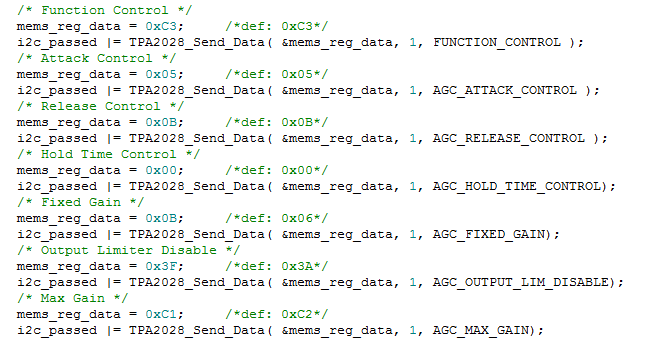

In one of our projects, we are considering to replace the existing amplifier with TPA2028. It seems that we need to set TPA2028 registers again after every EN pin disable/enable cycle.
Is it really necessary to do this all the time, or there is a way to keep the custom settings even when the amplifier is disabled?
