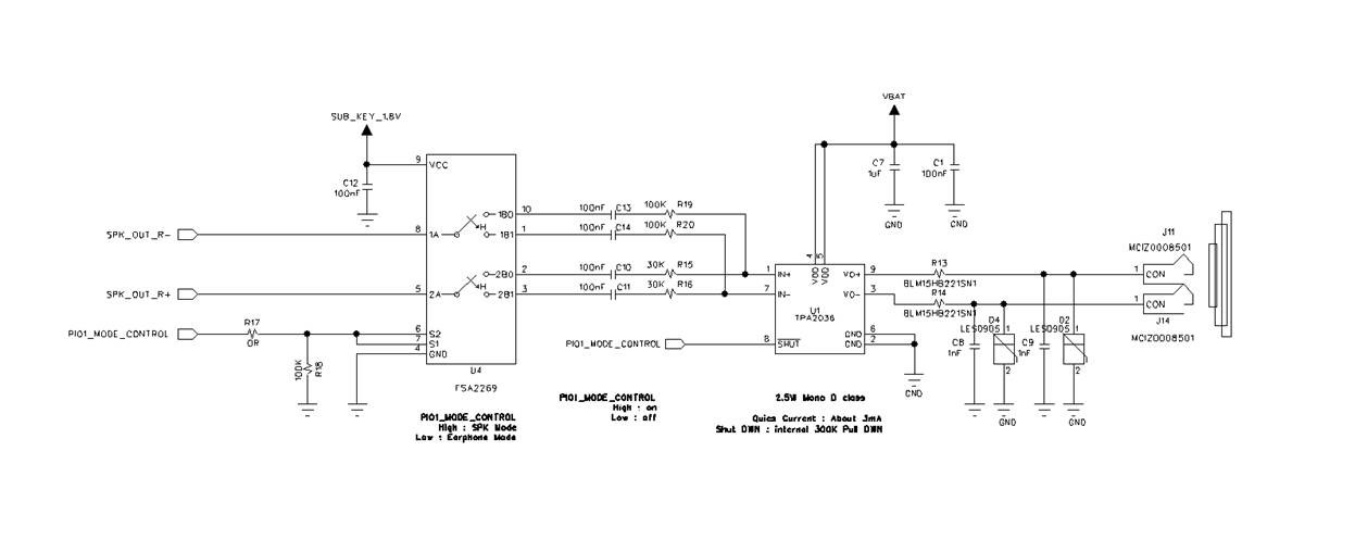

Hi there~
I'm Morgan and have question about "Separate gain mode with TPA2036D1".
Our customer wants to set different gain for A2DP and SoC source but chip only support one gain setting.
I saw  "The TPA2036D1 makes it easy to sum signals or use separate signal sources with different gains." in datasheet.
Would you please check below schematic is possible and anything to check more
Thanks in advance.
