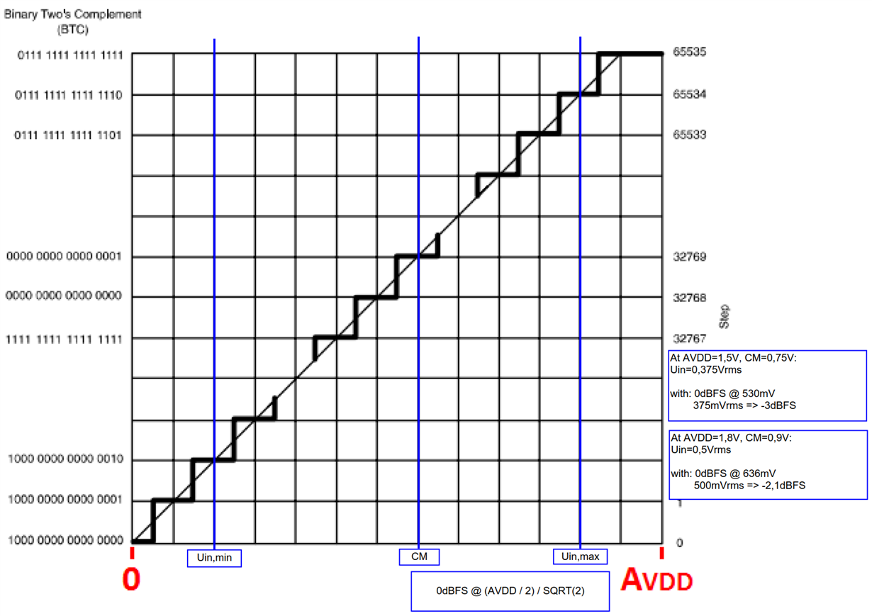

Using the AGC I want to check out the Noise Threshold feature. When I reduce the input signal, the Noise Threshold flag is set (Page 0, Register 47). When I increase the input signal, the Noise Threshold flag is reset. This works as expected.
However, the audio signal is not affected at this threshold. The gain is not reduced to 0dB. Instead the maximum gain is still active.
The signal input is IN1l / IN1R which is routed to Right-ADC.
Do you have any recommendation for me to solve this issue?
Page 0 / Register 101 shows the maximum gain, should this register show 0dB when the input signal is below the noise threshold level?
