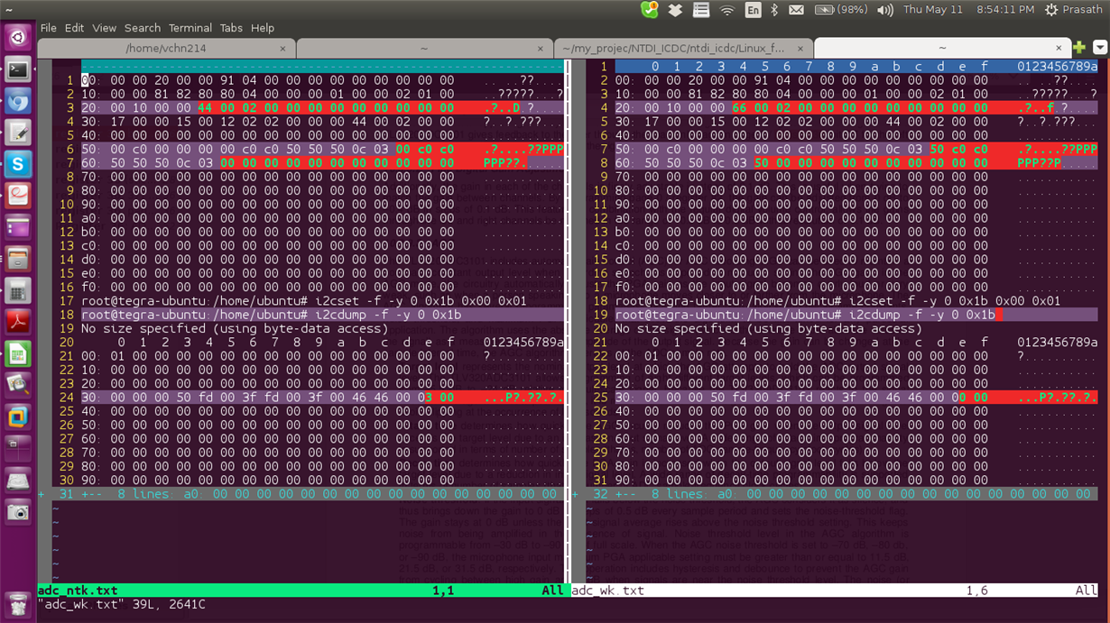

  • hi we are facing the same issue in one of our boards again
    AGC is set as zero automatically in this board
    I2C link is working fine the following is the register dump comparison of working and not working boards
    what else can be the cause

  • Hi Luis Fernando Rodríguez S.
    We have checked this and we have set this configuration through driver
    but still we are facing the same is there any thing at the pin level can be checked if the ic is fully functional
    we have probed the I2S lines B CLK INPUT TO ADC is it 256khz W CLK INPUT TO ADC is 8khz
    and we have taken I2C dump and captured the register values so i think I2C is working fine
    we are able to read the registers from the device so no issues in this
    and out of 20 board s only in 5 we are facing this problem
    thatch why we are not suspecting any th
    Could you provide details about the analog input pins (IN1L and IN1R)? What is the voltage level at these pins before and after the registers configuration? Additionally, are you using a MCLK signal? The registers are configured to generate the sampling rate from the MCLK.
