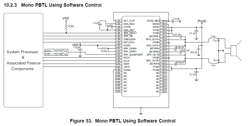

                    How can check the output polarity under PBTL mode?         Please check B-port is positive ,A-port is negative, Correct?
