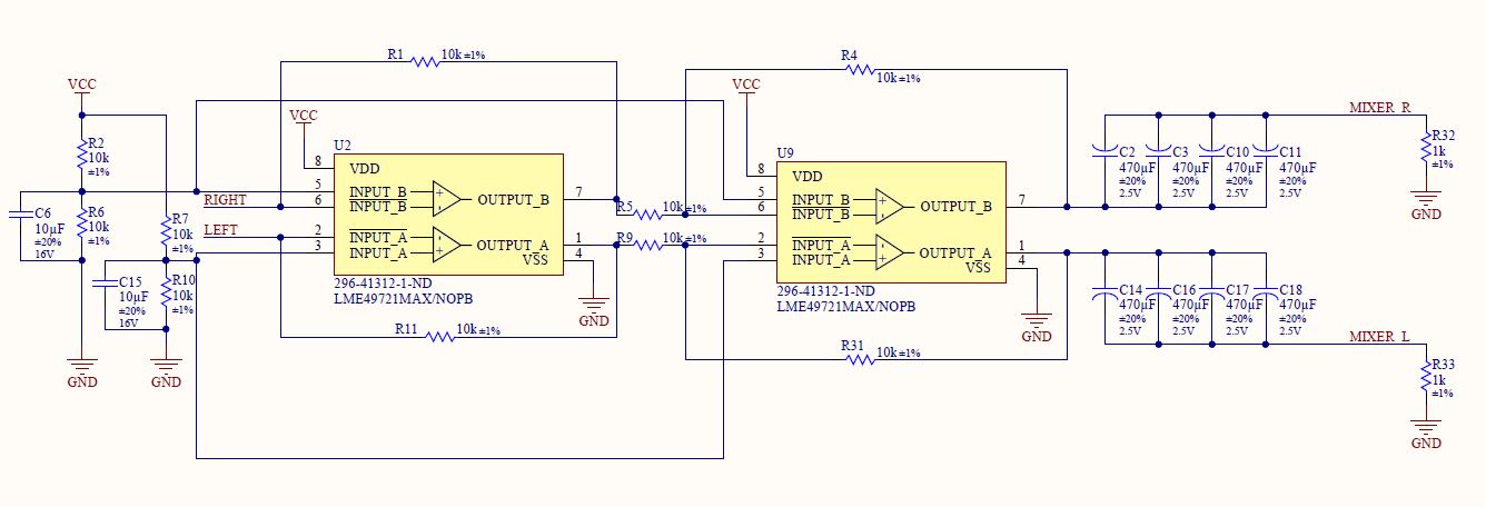

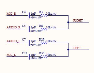

I'm using two LM4808 ICs in my audio mixer circuit. After I power the circuit (3V with 2 x AA batteries), I hear a popping sound when my headphones are connected to the outputs before about five seconds have elapsed. If I wait at least five seconds after power is applied, I don't hear a popping sound when I connect and disconnect my headphones. I followed the recommendations to reduce pop in the datasheet by adjusting the values of capacitors Ci and Cb, but it made no difference. I reduced the input capacitors (Ci) to 0.1 uF and it had no effect. It also had no effect to reduce my output decoupling capacitance by removing two 470 uF capacitors on each channel. I don't know why I have to wait so long after applying power before there's no pop sound. What could be causing this problem? Here is my circuit:
Note: the labels below the ICs should be LM4808...
  • Hi Icy,
    One thing I would recommend is to use a voltage divider (bias voltage) for each device. From the schematic above I see that one of the dividers is connected to non-inverting input B from both U2 and U9. The same goes for input A.
    What I would recommend is to use one divider for both input A and B from U2 and the other one for input A and B from U9. Or another thing to try is to use only one voltage divider.
    Perhaps these bias voltages are ramping different and it takes these ~5sec to be stable.
    -Ivan Salazar

  • I tried using only one voltage divider and I still hear a popping sound.
  • Have you tried by placing series capacitors at the outputs of the first stage? Perhaps the DC component is affecting the second stage input.
    -Ivan Salazar
    Applications Engineer - Low Power Audio & Actuators
  • I did place a 1 uF capacitor at the output of the first stage (for each op amp A and B) and it didn't make a difference.
  • Icy,
    The turn-on time should be related to some, or many, of these capacitors and resistors. For debugging I would follow some questions and steps:
    - What is the purpose of all those output coupling capacitors? Why four in parallel for each output instead of one?
    - If R32 and R33 are used to make the discharge time of output coupling capacitors faster, place them between device outputs and coupling capacitors, in parallel with internal 20kOhm resistors.
    - Both LM4808 stages seems to be unity gain. What is the purpose of having two stages if they're the same?
    - Is it possible to test pop performance at the first stage output?
    - Is it possible to test with a different supply voltage source for comparison?
    - Is it possible to use an oscilloscope to inspect several nodes in the circuit and try to identify which ones are taking long time to become stable.
    -Ivan Salazar
  • -The purpose of having four output coupling capacitors at each output was to get a larger capacitance (there wasn't a single suitably sized capacitor with this large of a capacitance), to satisfy a low frequency cut off. I removed two capacitors on each channel and it made no difference.
    - Ok, I'll try placing the 1k discharge resistors at the device outputs instead.
    - The purpose of the first stage is to mix the two audio input signals together (on each channel), and the purpose of the second stage is to de-invert the outputs from the first stage. It's just an application requirement to have the output signals not inverted from their original phase.
    - I would have to get board rework done to test the performance at the first stage output. I know I need both stages though.
    -I have tested with both two AA batteries and a 3.3V DC/DC step up converter
    -The supply voltage looks stable on the scope nearly instantly. I probed at the amplifier outputs and they also didn't look unstable after turn on.
    Thank you for the suggestions.
  • Icy,
    Have you tried by placing the discharge resistors at the device outputs?
    -Ivan Salazar
  • Yes, I tried that and it didn't make a difference.

  • Hi Icy,
    why not splitting the 3V from the two AA-batteries into a +1.5V and -1.5V supply?
    Kai
  • My application will require a single AA battery that is boosted to 3.3V with a step-up converter. For testing, it made no difference in regards to the popping sound whether I used the 3.3V booster or two AA batteries.
  • Hi Icy,
    I didn't mean a 3V single supply but a +/-1.5V dual supply. This would allow to omit the voltage dividers arround R2, R6, R7 and R10. The dual supply must have an audible effect on the popping noise, because all the AC coupling caps must not longer charge to Vcc/2!
    Kai
