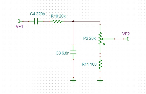

  • Hi Samuel,
    first, I don't think that you need the OPA134 anymore. This scheme brings nearly the same performance:
    Then, I would adjust the corner frequencies of the low pass filter and the high pass filter. If you only transmit 1.4kHz you can increase the corner frequency of the high pass filter and decrease the corner frequency of the low pass filter. Your filter circuit can look like that then:
    This will reduce the pop noise a bit when turning on the square wave and will further decrease the harmonics and make the square wave sound less harsh.
    Kai

  • Hi Samuel,
    If the RC low-pass filter has a 16 kHz cut-off its peak-to-peak output at 1.4 kHz will depend very much on the input waveform characteristics; amplitude, symmetry and duty cyle, etc. However, keep in mind a first-order RC, 16 kHz low-pass filter will have little effect on a 1.4 kHz square-wave because even the 11th harmonic is below that cutoff. A waveform resembling containing the first nine odd harmonics produces a pretty decent square-wave. You could move the filter cutoff down to provide more attenuation of the harmonics, but a simple first-order low-pass may not provide the performance that you need.

  • HI Kai,
    I use ISO7710F where its default output is low. In the transient stage when C3 and C4 are fully discharged and the output microcontroller change from low to high and vice versa.Could the circuit have a problem in those stages?
  • Hi Samuel,
    no, there's no danger, because the output current of ISO7710 and the current into the both caps C3 and C4 is limited by R10=20k.
    Kai
  • Hi Kai,
    In your circuit, the cutoff frequency for the low pass filter (R10, C3) is 1.17 kHz, but I can not calculate the cutoff frequency for the high pass filter. Please explain it.
  • Hi Samuel,
    let's run a TINA-TI simulation:
    The 10k in the right is coming from the input impedance of DRV135.
    Kai
  • Hi Kai,
    Simulation was fixing a value of P1, Could run simulation for high and low value of P1?, What is peak of the “pass-band” frequency range? In picture I can see 380Hz as center, Is so ok?
  • Hi Kai,
    If value of R2 is decrease to 10 ohm, Which is effect on cutoff frequency?
  • Hi Samuel,
    this will not have a noticable effect.
    Kai

  • Hi Thomas,
    That's right, 1.4 kHz is close to high frequency roll-off, for this reason I want to move cutoff frequency to 2 kHz at high pass and 500Hz at low pass and 1.4 kHz at center. I don't how to calculate or place value for each capacitor and resistor, Could you teach me how to calculate it?
  • Hi Samuel,
    I have simulated my scheme for you and highlighted the -3dB corner frequencies. Depending on the 20k pot setting the low pass corner frequency shifts from 2.5kHz to 4.8kHz. This is intended because with a higher corner frequency the low pass filtering will become useless and the higher harmonics of square wave will kill your ears.
    What exactly do you want? A bandpass with a center frequency of 1.4kHz? Or do you want to shift the low pass corner frequency downwards to lower frequencies?
    Kai
  • Hi Samuel,
    The passive circuit although looking pretty simple has a very involved transfer function (see below). Deriving any partiulcar compenent value is very involved and time consuming. Changing the potentiometer wiper position has a big effect on where the high-end -3 dB cutoff frequency occurs, and much lesser effect on the low frequency -3 dB cuttoff.
    As currently designed the - 3dB frequencies are far apart; around 15 Hz on the low end, and about 2.1 kHz on the high end when the potentiometer is in the mid position. However, when an attempt is made to move the low-end cutoff up to 500 Hz while maintaining a near 2 kHz high-end cutoff things become complicated for this passive filter circuit. Basically, the high-pass pole of the low frequency cutoff and the low-pass pole of high frequency cutoff move very close to each other. Essentially, their responses cut into each other and additonal attenuation occurs within the passband.
    If you really want a decent band-pass response with accurate 500 Hz and 2 kHz cutoff frequencies, and the ability to have them hold as the gain potentiometer is adjusted, I recommend that an active op amp filter be used instead.
