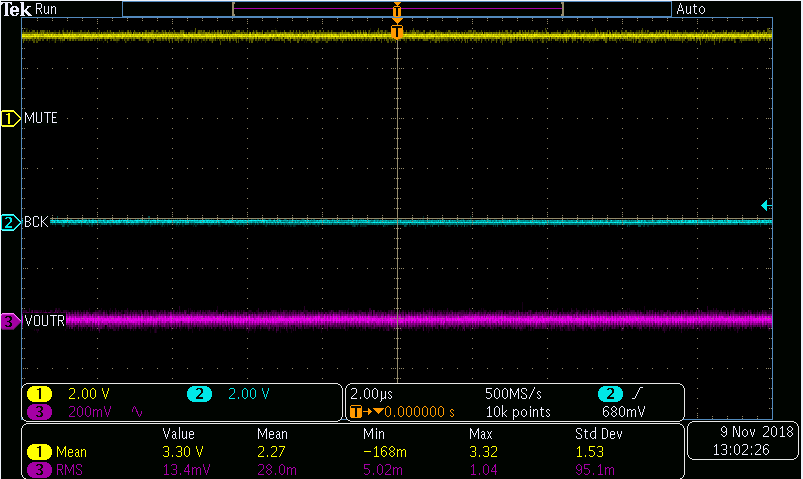

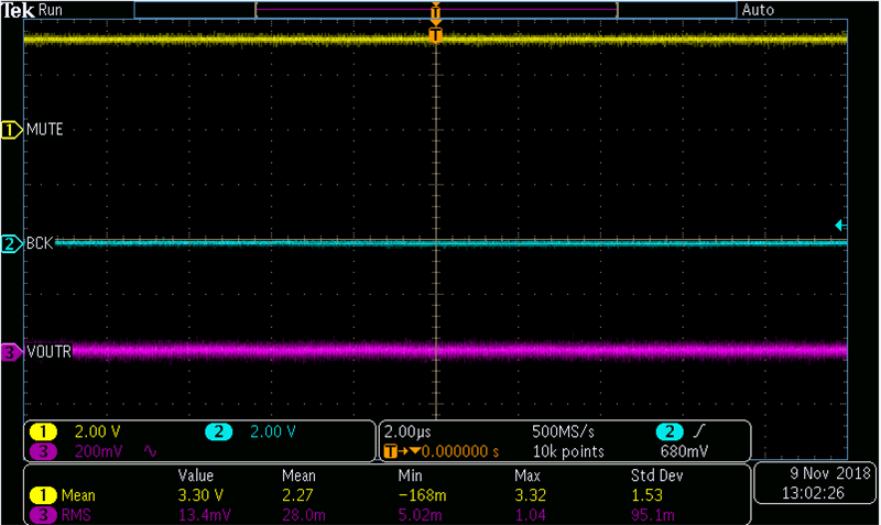

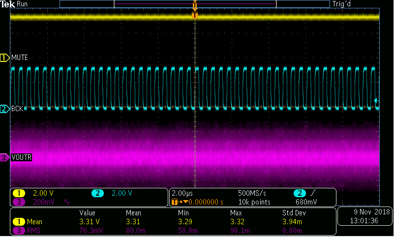

The customer find there is still output on VoutL/R. The waveform is as below.
After the BCK is removed, no output. The waveform is as below.
Is this normal?
Could you please look into this case? Thanks.

    This is quite a bit of noise - is there a possibility of crosstalk between BCK and the output? Is there any output filtering in this system?

    The most strange thing is the MUTE function could not be actived no matter what the voltage on this pin.
    Is this normal?

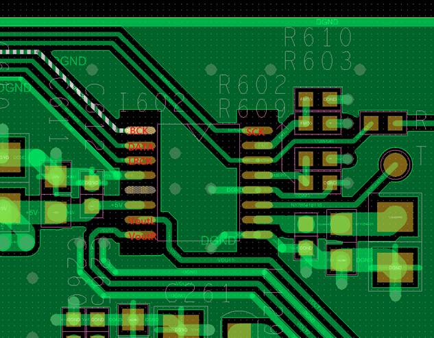

    Below is part of the layout, it seems the BCK is far away from VOUTL/R pin.
    Robin

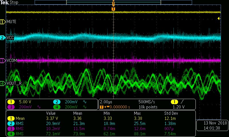

    Can you look at the VCC supply and VCOM pins during the noise event? Do you see the noise on those two pins as well? If you do, then I think you have a digital crosstalk issue, as the PCM1754 does not much power supply noise rejection.
    Paul
  • Hi Paul,
    I am not sure whether the noise is induced by VCC & VCOM or not.
    Please check the waveform as below
