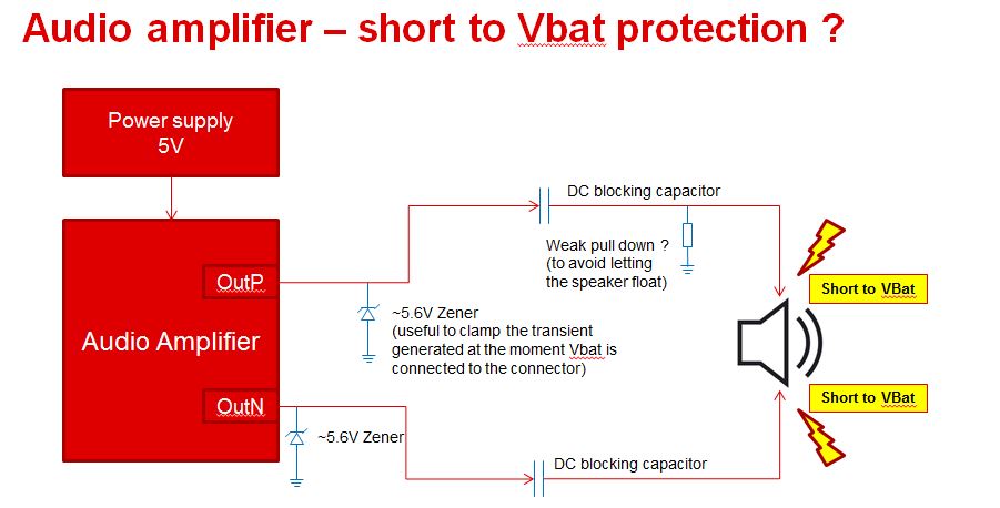

  • Hello Ivan,
    Would that be possible to place DC blocking capacitors to this BTL class D amplifier output ?
    Thanks!
    PA
  • PS: to illustrate what I meant, very simple block diagram below.
    In case that works, how would we select these blocking capacitors ? in my mind they would be quite small since they are connected with a high frequency H bridge and not an analog type of signal.. but I feel like it won't work for some obvious reason I don't see.
  • Pial,
    This might not be possible for a Class-D output like LM48312. It would only work for Class-AB (analog) output.
    -Ivan Salazar
