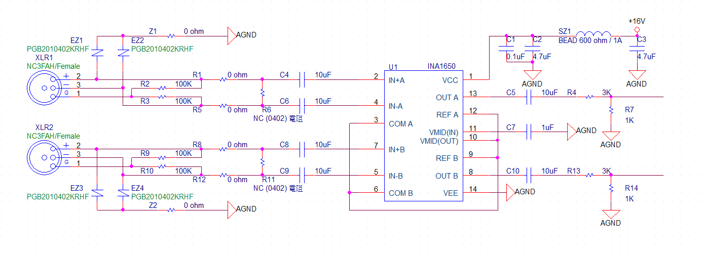

INA1650: XLR receiver schematics review
Part Number: INA1650
Hi
Would you help review my INA1650 XLR receiver schematics below, is it looks ok or any suggestion ?
  • Hi PYTsai,
    Thanks for your post. I have reviewed this and it looks good. My only concern is the C7 filter capacitor of 1µF at VMID(IN), this can lead to a time constant of 0.5 seconds or more. If this is unacceptable, consider adding a zener diode as shown in section 8.1.3 of the INA1650 datasheet to reduce this start-up time.
    The section I am referring to can be found on pages 19 and 20 of the datasheet.
    INA1650 datasheet: http://www.ti.com/lit/ds/symlink/ina1650.pdf
