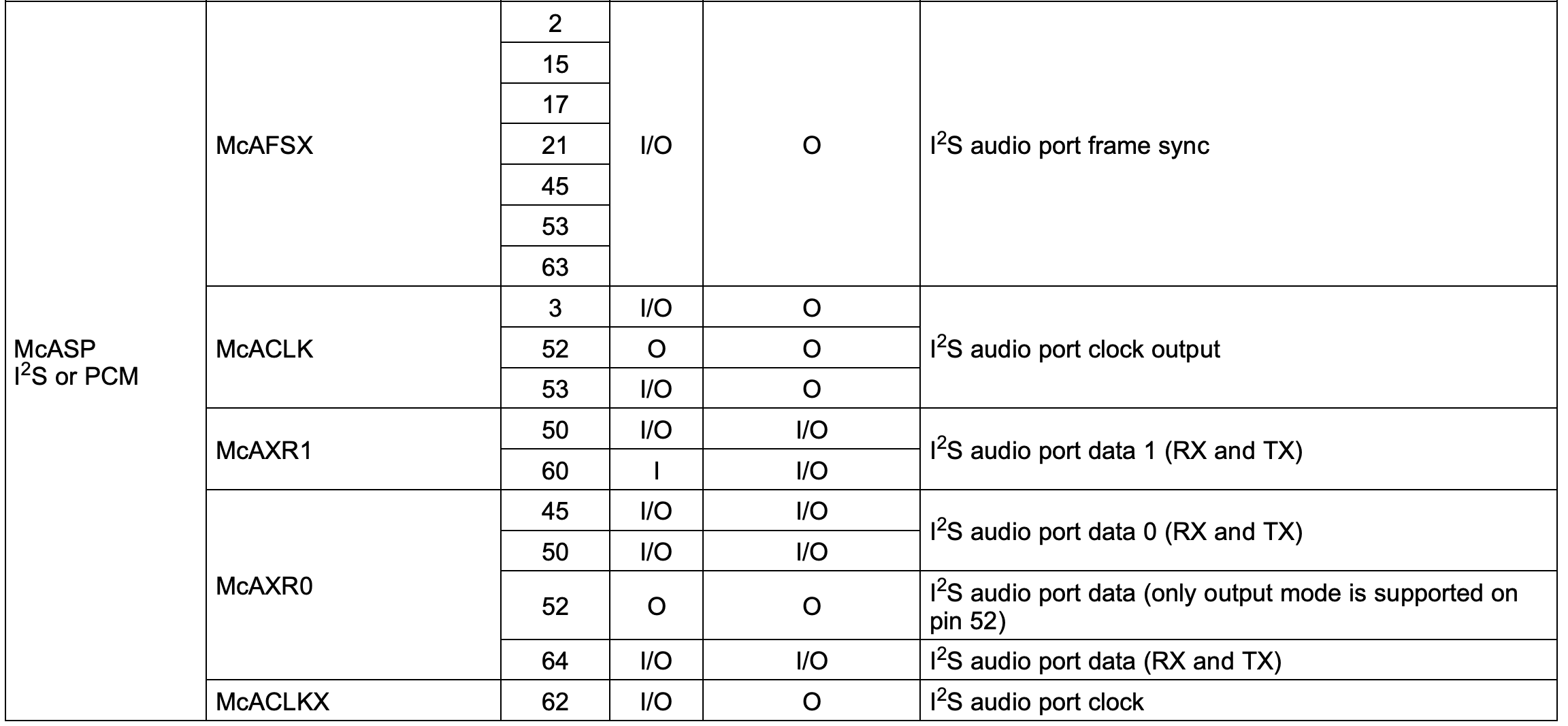

Hi, guys. I'm trying to create a custom PCB that uses the CC3320SF and TAS2505.
Considering CC3220's pinouts,
What pins should I connect between them? (ex.McACLKX 64 - MCLK)
I'm trying to send and play WAV file data via I2S and I will be using SPI for configuring the TAS2505's registers.
The MCLK is most confusing for me. When I used other vendor's device,
I only used BCLK, LRCLK with the Raspberry Pi so I'm having trouble here. Thanks for your help.

    When a controller is connected to the TAS2505, it is always important to ensure that all serial data interface and control lines are correctly connected from the controller to the TAS2505.
    The control lines can be SPI or I2C lines. These lines will be necessary to read and write the registers of the TAS2505.
    In case of the serial data interface lines, you would need a device that supports I2S (or similar) protocol. At least, you would need of the word clock (WCLK) or frame clock, which determines the word or channel (usually left or right channel data). Then, the bit clock (BCLK) is required to send the bits per channel. Finally, the data lines DIN and DOUT, which will be sending the data to be sampled.
    The MCLK is only required for cases where the BCLK and WCLK cannot be generated from an external controller. The TAS2505 has the capability to work in slave (BCLK and WCLK configured as inputs) or master mode (BCLK and WCLK configured as outputs and generated from the MCLK).
    If your controller has the capability to send BCLK and WCLK clock signals to the TAS2505, there won't be need to use a MCLK. MCLK pin can be left floated.
