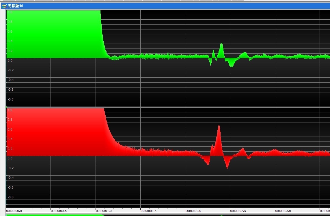

Circuit is a typical application of TLV320AIC3101 datasheet. We started recording with TLV320AIC3101, and there was a broken sound about 0.4s. Is it normal? Monitor with earphone, there is obvious pop sound. Is there any way to solve this problem?

    This will depend entirely on your recording sequence, can you share your sequence with me?

  • Amy,
    Here are my recommendations:

    //The delay below should match the ramp up time set  in register 42.  this is to allow the output to power up.Alternately wait until Reg 94 D1 = '1'.
        CyDelay(500);
        CodecRegWrite(AIC31_P0_REG51, 0x09,sizeof(CodecWrite));
        CodecRegWrite(AIC31_P0_REG65, 0x09,sizeof(CodecWrite));
    //  the delay below is a function of the soft stepping. if set to 1step per sample this is 508/fs .  if set to 1 step every 2 samples then 1016/fs.
       CyDelay(500)
        CodecRegWrite(AIC31_P0_REG43, 0x00,sizeof(CodecWrite));
        CodecRegWrite(AIC31_P0_REG44, 0x00,sizeof(CodecWrite));
        CyDelay(500);

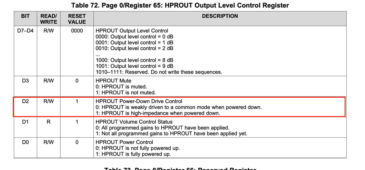

    If you can make use of the weak bias on the HPOUT,  that would eliminate any residual pop on power up. so if you enable the weak bias when the device first initializes only,  that would do the trick. of course there is a slight current draw when this is enabled.  so make sure it is acceptable for you.
