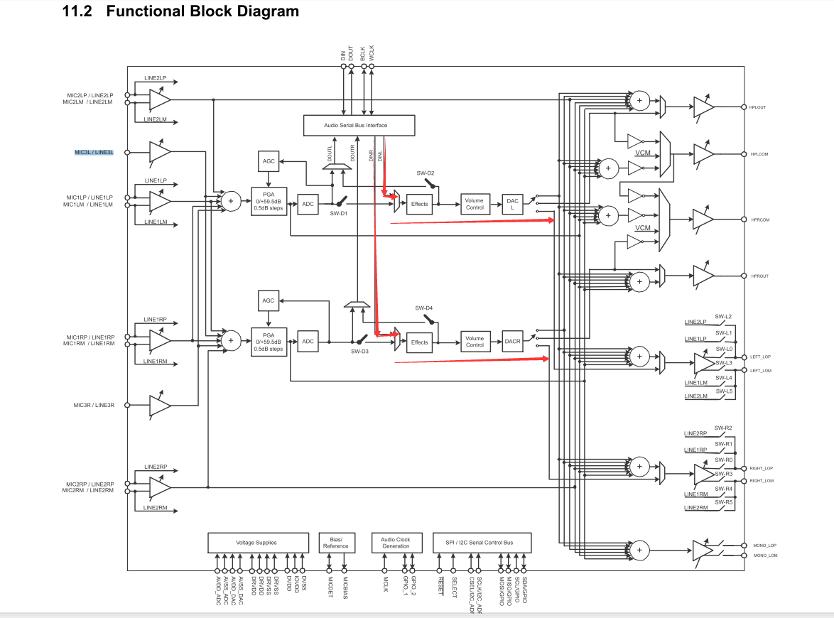

external i2s,MCLK=12MHZ,WCLK=48KHZ,BLCK has audio data input with Oscilloscope,, but LEFT/RIGHT_LOUT Can't produce sound,why? thanks!

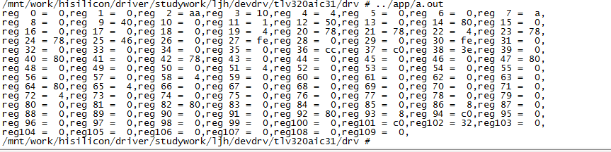

this is 3106 registers value
tlv320aic31_write(IIC_device_addr[chip_num], 7,  0xa);/* FSref = 48 kHz */
/*left and right DAC power on*/ || soft_reset
tlv320aic31_write(IIC_device_addr[chip_num], 37, 0xc0);
 /*left DAC not muted*/
 tlv320aic31_write(IIC_device_addr[chip_num], 43, 0x0);
 /*right DAC not muted*/ ~
 tlv320aic31_write(IIC_device_addr[chip_num], 44, 0x0);
//left-dac
tlv320aic31_write(IIC_device_addr[chip_num], 82, 0x80);
tlv320aic31_write(IIC_device_addr[chip_num], 86, 0x08);
//right-dac
tlv320aic31_write(IIC_device_addr[chip_num], 92, 0x80);
tlv320aic31_write(IIC_device_addr[chip_num], 93, 0x08);

    There is actually an error in the data sheet. Bit D0 in registers 86 and 93 should be R/W. This bit in these registers will power on the left and right line-outs. Please write 0x09 to these two registers. Also, please make sure you are using the correct ASI format. In register 0x09, you are writing a value of 0x40 (Assuming these contents are in hex). This uses DSP mode and requires WCLK to have a one bit pulse. You can see the ASI communication requirements in section 11.3 in the data sheet.
