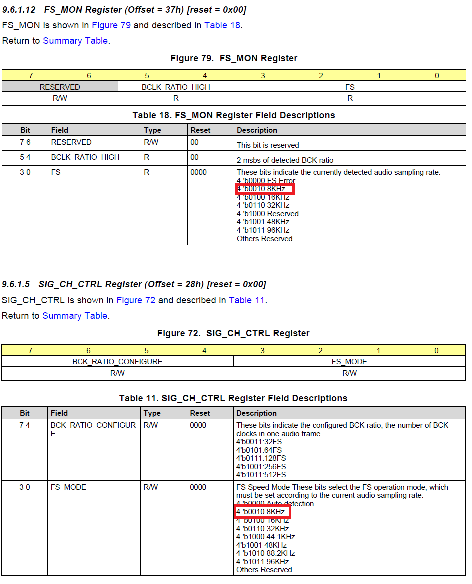

The TAS5805M datasheet indicate startup procedure requires I2S to be stable before sending I2C commands to TAS5805M.
Is 'stable' means the clock is not halt, and the ratio of SCLK/Fs is 16, 32 or 64?
If I have continuous close with SCLK=512KHz and Fs=8KHz, ratio = 512/8 = 64, consider a stable I2S clock?

  • Dear ALix,
    Looks like TAS5805M support 8KHz.
    We do not need TAS5805M to support Fs=8KHz playback.
    We just want to make sure when SCLK/Fs = 512KHz/8KHz, can we send configuration parameters to TAS5805M via I2C  without issue.
  • Hello customer,
    Per my check with designers, 8K Fs is not supported in our specification. I will update the datasheet in next version.
    As to your need for 512/8=64, i am afraid that it is possible to report error. Can you share why it is a must to have SCLK=512K and Fs=8KHz, is it for human voice?
    Can you consider to use SRC to up-sampling the Fs to 32 with a factor of 4? It is not hard for MCU/SoC. Thanks!

  • Hi CK,
    If you do not do I2C configuration of DSP (not in book 0 / page 0), it is ok.
    But my concern here is:
    1. During the I2C initialization, I2S clocks are needed to be stable and valid. 512k/8k is not allowed;
    2. After the I2C initialization, you need to do wake up or mute the device, it is ok. But my suggestions here is:
      1. mute:
        1. 44.1KHz is ready:
        1. mute/sleep the device
        2. change the clock to 8k
      2. play:
        1. keep in mute status;
        2. wait for LRCLK to be 44.1k
        3. enter into play
    Alix Wan.
