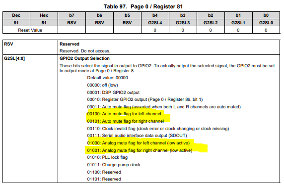

  • Hi Jun,
    This might be possible in the DSP, but it would probably be easier to just use the auto-mute features in the device and set one of the GPO pins to be the flag.

    "The PCM514x devices have two auto-mute functions to mute the device upon power loss (intentional or unintentional)."
    "This bit controls the behavior of the auto mute upon zero sample detection. The time length for zero detection is set with Page 0 / Register 59."
    That idea sounds great. But I think that auto mute function can only detect zero sample. Even the input audio is silent, my audio system also have some background noise, and can not be zero samples.
    So I think it must have a threshold level to be set.  For example, If greater than it, output 1. or not output 0.
